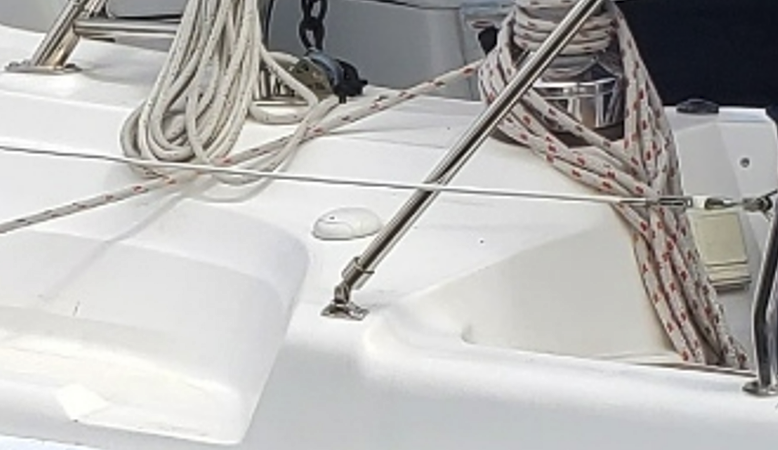

I replaced the original chart plotters with Axioms. I will be installing AIS in the near future and thought that would be the ideal place for its GPS antenna.

Already have. Raymarine (I believe it is a Raymarine 125) bolted the flush mount through the mounting surface with washers and nuts on the backside. There are no penetrations but the one for the cable. So, I am head scratching and asking the bigger brain.

There are no nuts to remove, thus my quandary. And I wanted to ask the group before I try to do anything else for fear of damage.

I used fishing line to cut through the adhesive. Then I pried it off with a putty knife. There are no screws. There is a small hole in the deck for the wires and that's it. I replaced the battery in my unit and had to remove it to do this. It works fine now.

The nuts and washers only keep the bottom and top of the unit together. They don't bolt the unit to the deck. You need to remove the whole unit to unscrew these bolts and gain access to the inside where you can change the internal battery. Use the fishing line. You'll be able to feel the adhesive give way as you saw it back and forth. That way you know you’re not cutting through anything important. Stop when you get close to the center and adjust your angle. You don't want to saw through the wires. I used 80 or 100 pound test.

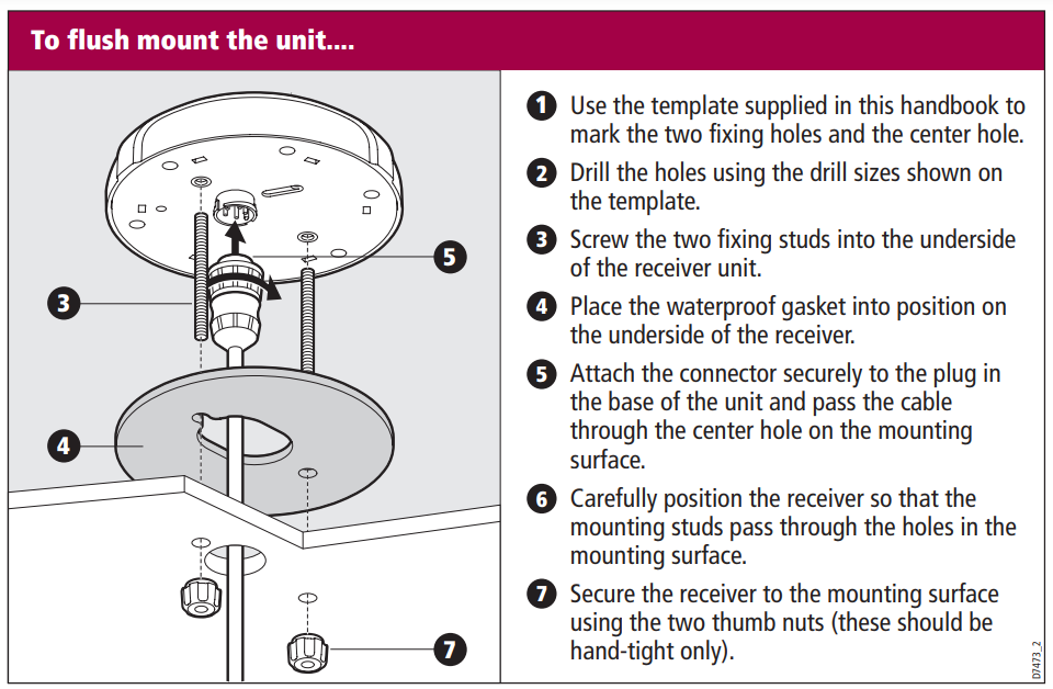

I'm thoroughly confused by the OP releasing small bits of information on a need to know only basis. The disclosure of this information in your first post would have saved a lot of back and forth if you had initially described the antenna as a Raymarine 125, described that you had looked below deck at the installation, described what you had seen below deck, and a few other vital details which you failed to relay and kept everyone guessing.
I'm sure you've seen this installation page in the Raymarine manual. Yours does not appear to have been properly installed. As described in posts #10 and #11, @Georgedoyle had the same unapproved installation which requires the sealant/adhesive to be cut away with fishing line.
