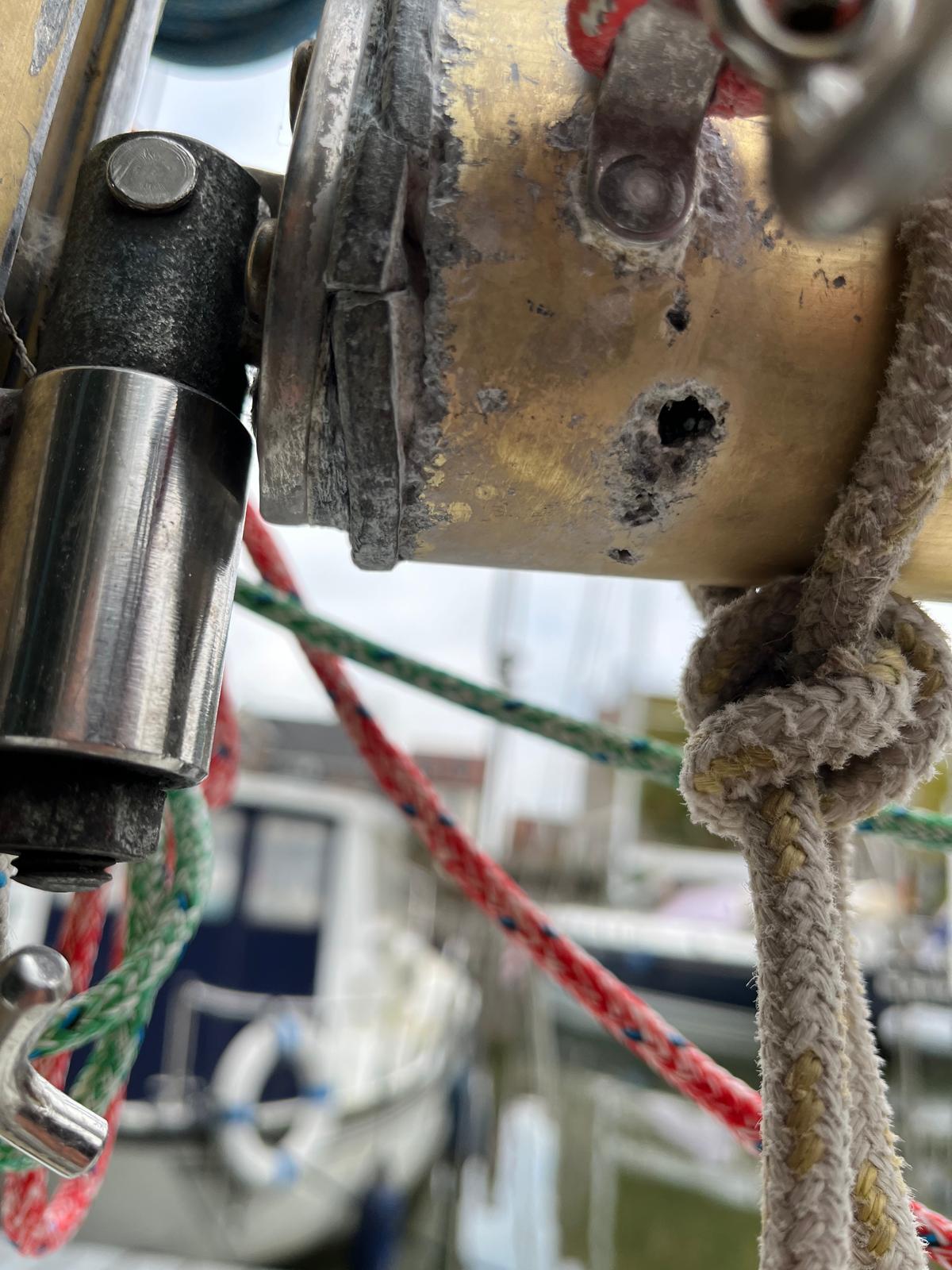

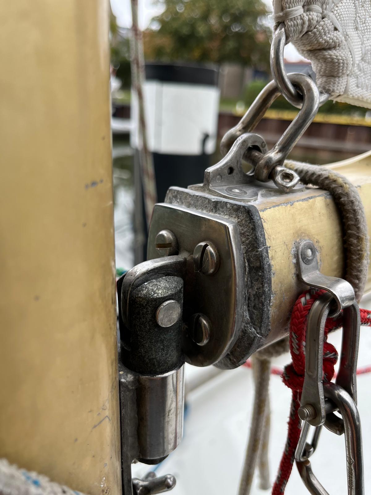

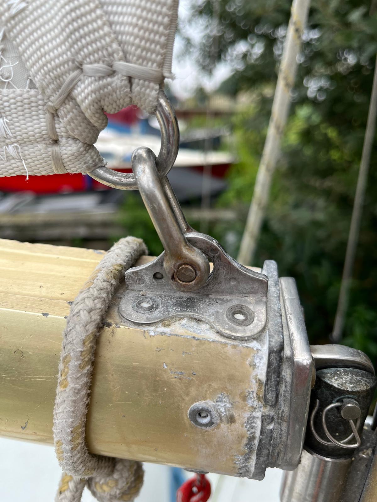

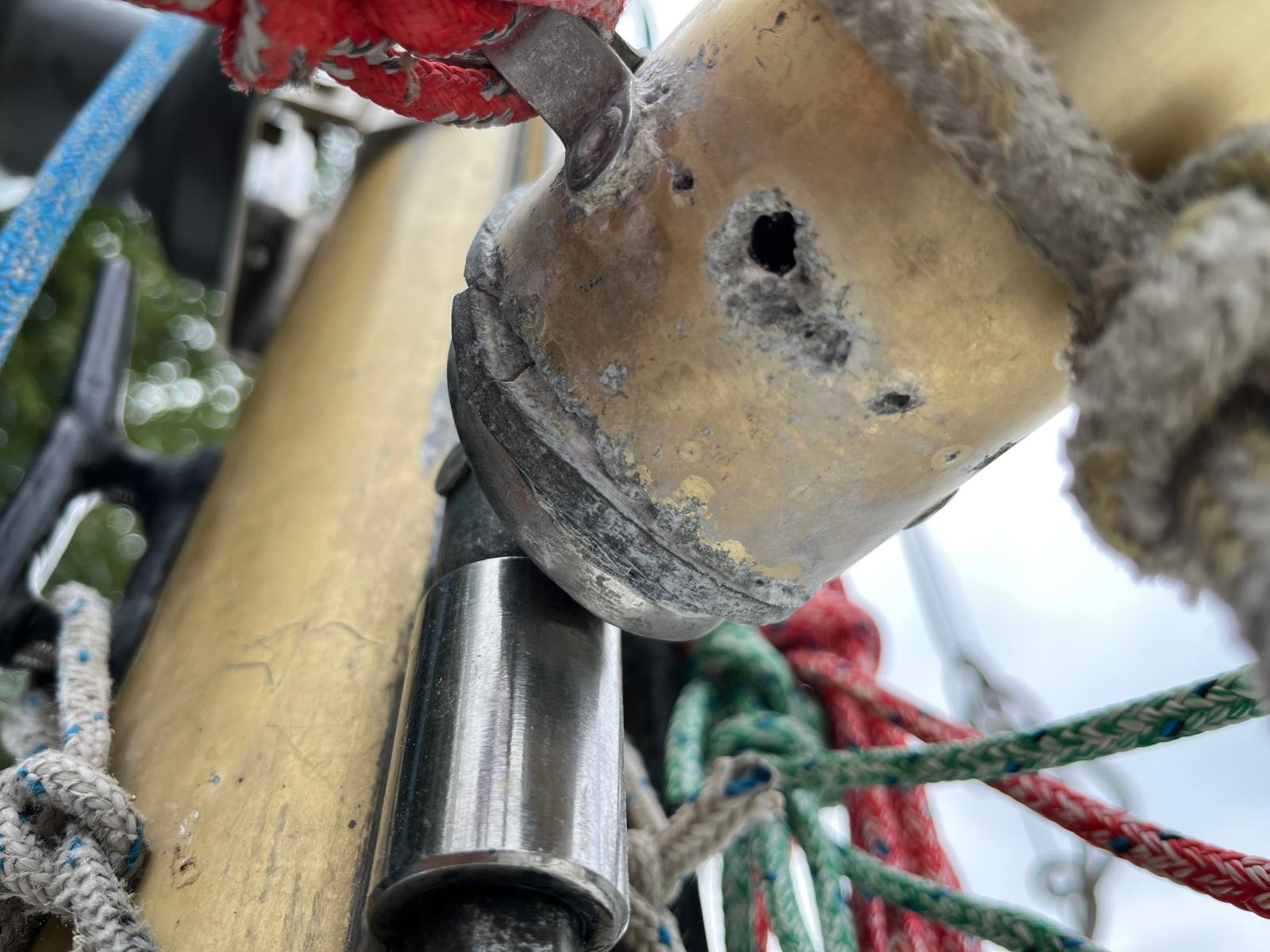

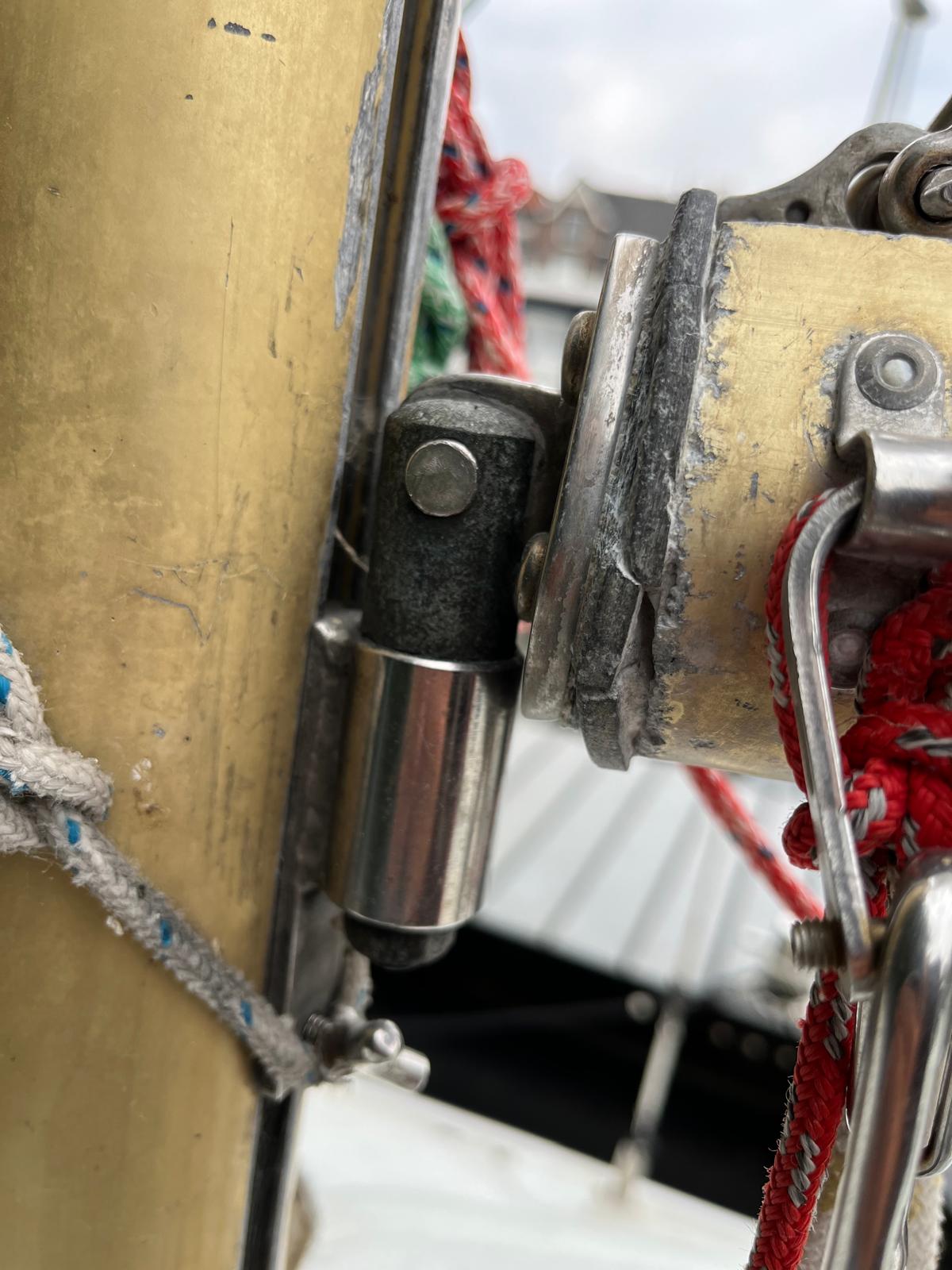

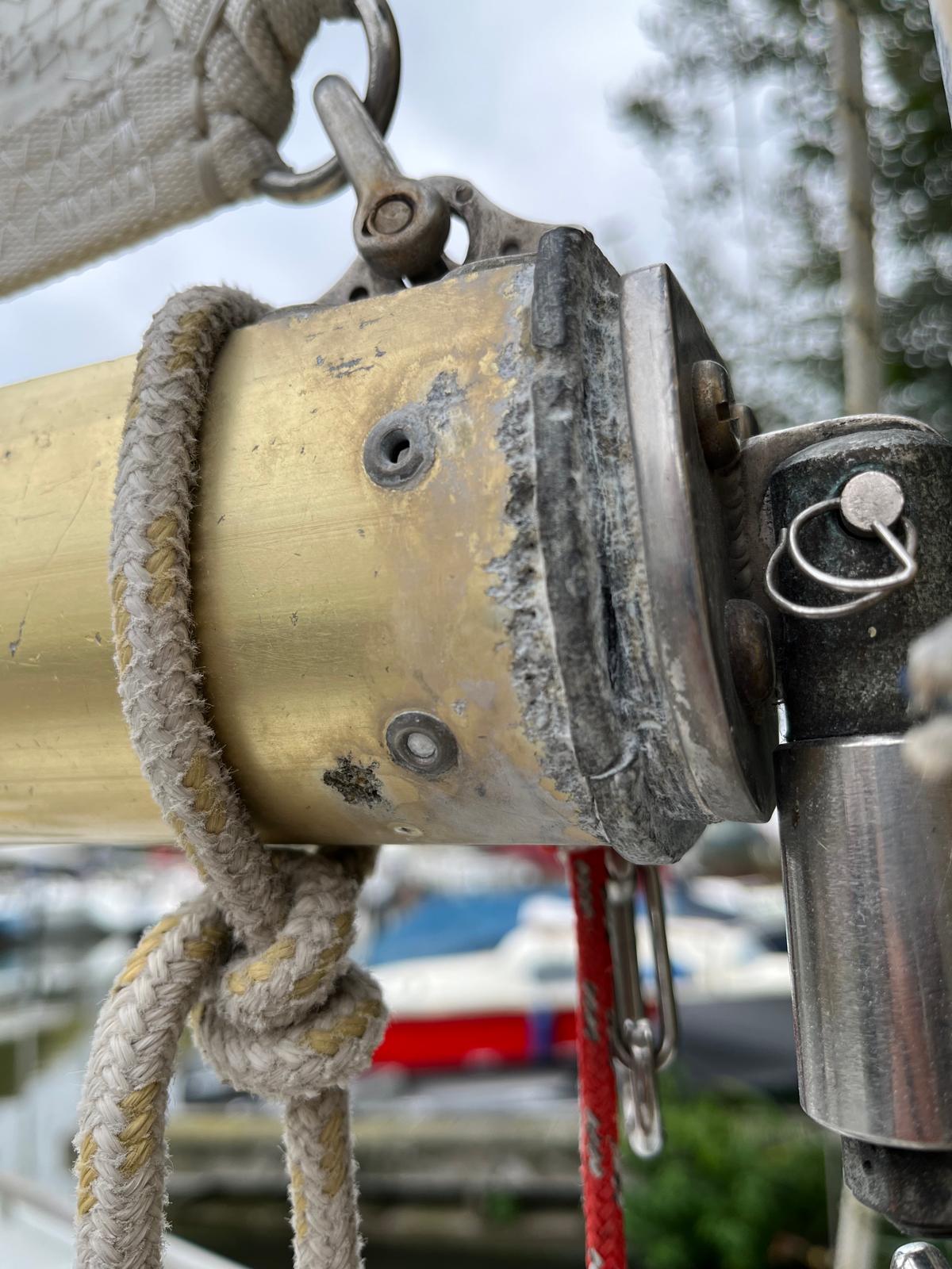

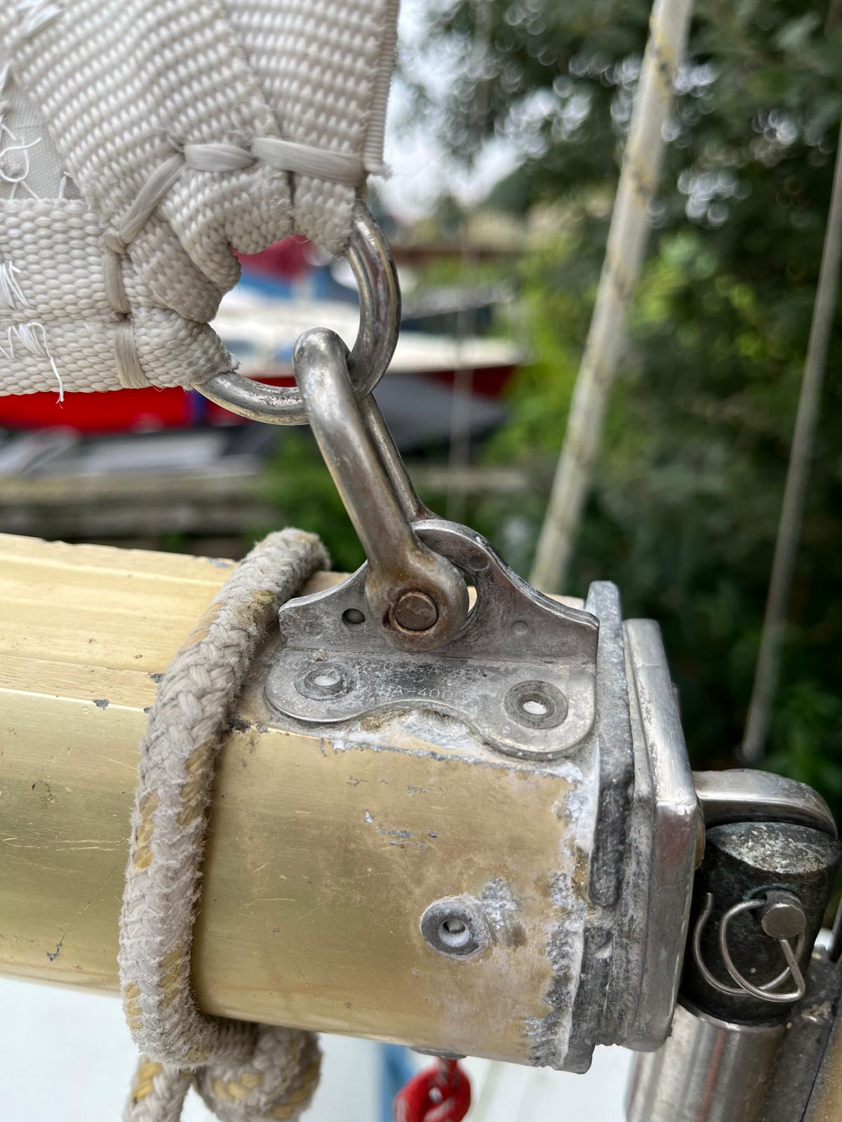

Ayo sailors, I am somewhat of a beginner, tormented by the galvanic corrosion at the goosneck.
I need a bit of your wisdom:
- Is it still sufficiently safe?
- How urgent is it to repair?
- What would you do?
For context, the boat is a small 22ft, used mostly in inland waters and sporadically along the coast.

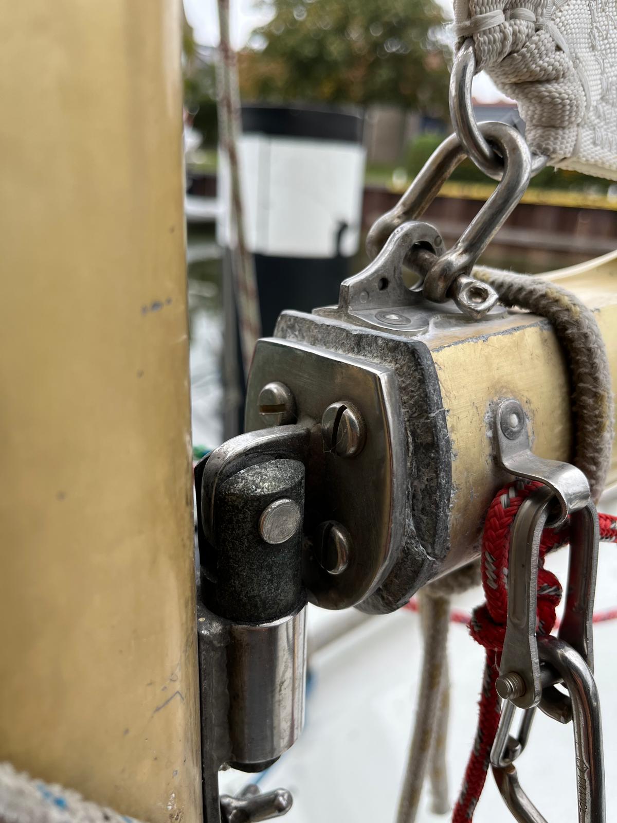

The problem looks like it is mostly with the boom's end fitting, which has cracked. The other corrosion doesn't look like it has impacted the structural integrity much. Finding a new piece will be a problem for something as obviously old as this is. Taking it apart to fix it might be possible, but you would need the new part to replace it, so... poor ROI. Since it is relatively small and transportable the best bet might be to take it to a shop that welds aluminum and see if they think adding a bead to the crack and joint would firm things up. If so, let them clean it up a bit and have at it. The loads on a boat of this size are not huge and you could also simply sail the boat and monitor the crack to see if it gets worse. The sail, sheet, and vang should keep things manageable until you get back to port if it does suddenly let go. But then you'd have a broken boom.
12,746
Are there any indications of who the manufacturer was? It might be a stamp or a sticker on the boom or mast?
If so, it’s very likely you can order a new end cap. look at the out haul on your foot of your main sail… if you have a few inches to spare there, then go back to the gooseneck take a hacksaw and saw off a half inch or so put the new endcap in and you’ll have fresh clean metal that’ll last you another 30 or 40 years.
Hard to say, but given where and how you are using it, I'd say yes.
Looks like a great winter project.
I'd take lots of measurements of the sail and boom. How much extra room, if any, at the end of the boom do you have? If you cut the end of the boom back, can you cut it far enough to get back to good metal and still have enough room to get the sail in the sail track and have enough boom left to fully stretch out the main sail? If yes - cut it back. If no, see how far you can cut to get the majority of the corrosion removed. Can you find a used boom in decent shape? Might be easier if you can do that and of course if it doesn't cost a lot.
If rebuilding - Take the whole mess apart. Might be fairly frustrating to do so.
See exactly how that broken part was manufactured. Try to find a replacement - if not possible, have one built. When reassembling - isolate all the stainless contact points with tuf-gel and reassemble...

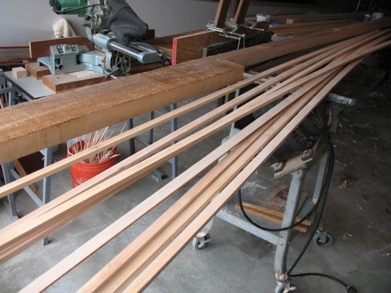

You could build a wooden boom.... that would look very salty.....
Here are some plans I found online ... I'd go with laminate cedar and spruce strips for extra strength and then make the center hollow to keep weight down.

Thank you for all these different angles, much appretiated!
I will try to sort it during the winter break.
The boat is from the 70's and the manifacturer is out of business, so sourcing parts is not simple... Taking the whole mess apart is indeed a frustrating scaring prospect...
1) Cut boom and replace the fitting --> Will an average workshop do a custom made new fitting if I bring the sliced out piece of boom for measuring?
2) Patching crack and pitts by welding --> brilliant, will inquire :)
3) New boom --> The sail has slugs along the entire foot, sliding on a track in the boom. From a fast search, I could not find new boom profiles compatible with that, with most new stuff having only a skinny grove for a bolt rope foot . Am I maybe missing the right keywords here?

Yes - not an easy project... It will be hard to find a new part to go in - if imposible. It will be hard to find a used boom...
I would not cut the part out of the boom first, I would try to remove it by drilling out all the rivets holding it in. If You can't get the part out and you have the room to cut the boom back, then you might make that cut and peel off the part of the boom over the end piece. But I wouldn't cut first, I'd try to remove that part first.

Most likely your mast was built by Kenyon Isomat. Rig Rite might still have parts from them. They would need to see the profile of your boom's "hole".
Go to this page and look at the boom profiles and see if any match your's.
If so, you can just call Rig Rite and talk to someone about a new end cap (assumeing you have enough room to cut) or if needed order an entire new boom and gooseneck.
If Rig Rite does not have what you need, you might also check Dwyer Mast & Rigging - Quality Sailboat Parts and Rigging

If you are able to dismantle the boom end pieces you might be able to make a replacement boom end fitting out of a block of wood. The piece is really only a plug at the end of the boom that you could shape out of a piece of oak, maple, or even Douglas fir. You could hold it in place with screws instead of rivets. The stainless plate would then screw into it on the end too. Not overly difficult.

If you do decide to replace the boom, I would not use the old slides, but do a "loose footed" attachment of the foot of the mainsail to the boom. Just cut the slides off the sail.

I didn't read whether there is extra boom length or not. If yes, this is pretty simple for a machinist, even an amateur. A few hours.
The fitting is stainless, bolted to an aluminum plug in the boom. I would cut off about 1.5 inches of the boom, then cut just behind the SS fitting to free the bolts (probably seized). I would then cut a new plug on a band saw from ~ 1.5" aluminum plate (or two thinner sheets more likely) to fit in the boom. Then relocate the fittings, perhaps with a few added machine screws to secure the plug.
The curves of the cast fitting need not be replicated.
A portable band saw with a stand and table make it pretty simple.

I would remove the boom and work on it in a shop. It will not spontaneously improve.
Sailing inland in moderate to mild conditions will eventually wear down the boom towards failure. Heading out coastal onto the North Sea will speed up this process with potential to sudden failure and a serious issue.
Welcome to sailing older boats. They need maintenance to keep giving you joy.

If your old sail won't fit when you cut some of that end off, you can always have a new sail made to fit new dimensions. There are numerous options presented here. The old fitting looks bad and needs to be replaced. I think I would cut the boom off just far enough to remove those old rivet holes that look bad. Either find a new fitting to match the boom profile or fabricate an end fitting. If you are thinking about replacing your main sail, it is a good time to do it to match the new boom dimension. You also may be able to re-cut your old sail, but I think it is likely that won't be a desirable option.
