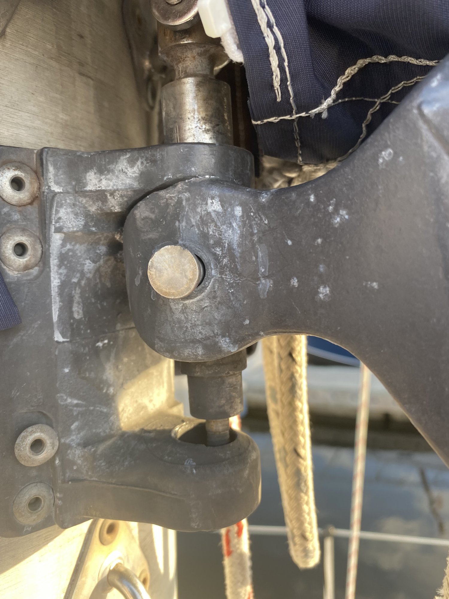

So, when I was getting the boat ready for Tropical Storm Ian. I discovered the goose neck. I do not know where I can find another for a Vision 32. May have to have a machinist make it $$$$$$$ As you can see it popped up. It had been hidden from view by our Mack Pack. It is always something

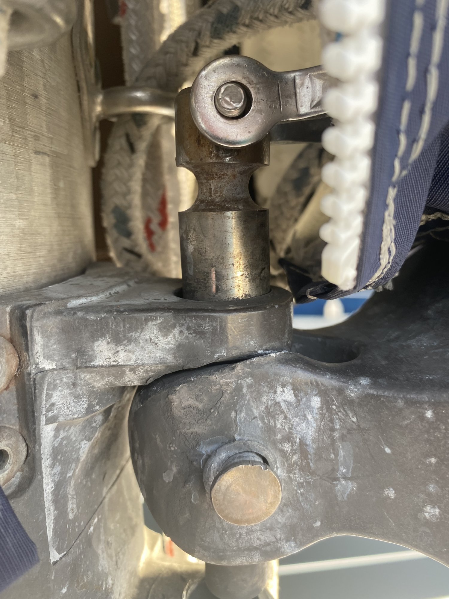

I appreciate it. We were able to get i back in place after removing the pin on the top part of the Isovang. Now the problem is how to get the Isovang to compress so we can get the pin back in again. to the fitting. Remarkably we were able to thread a nut on it again. Do not know how it supposed to look but the boom moves very freely. Now if we can only get the pin back in and we will be back in business
