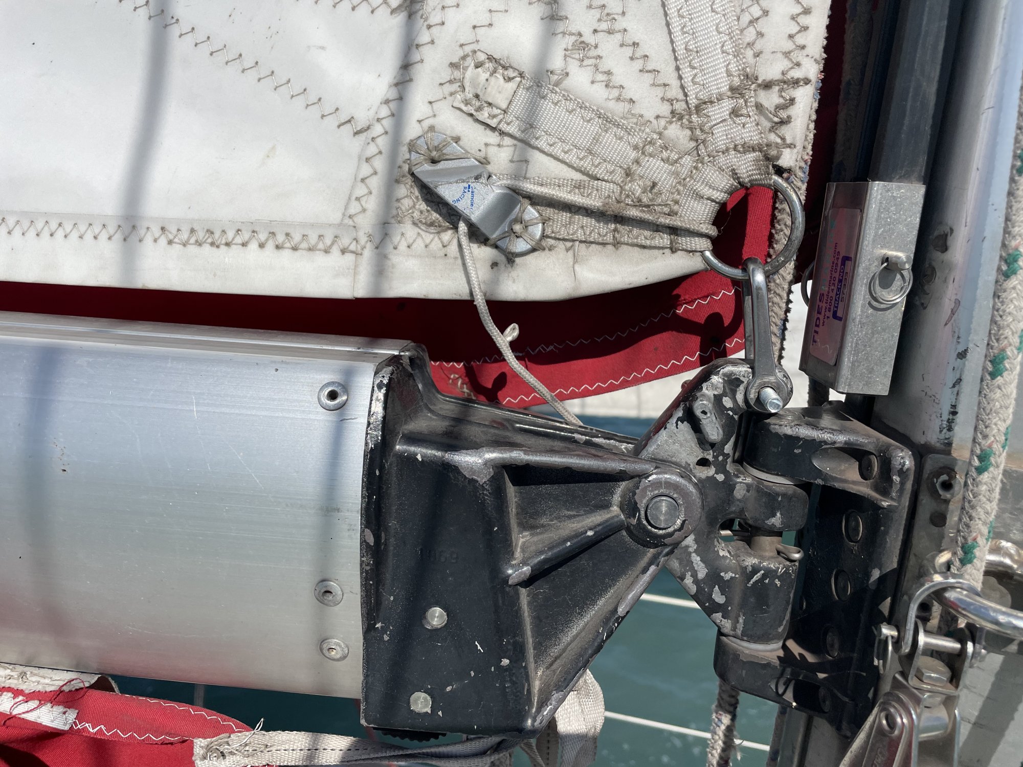

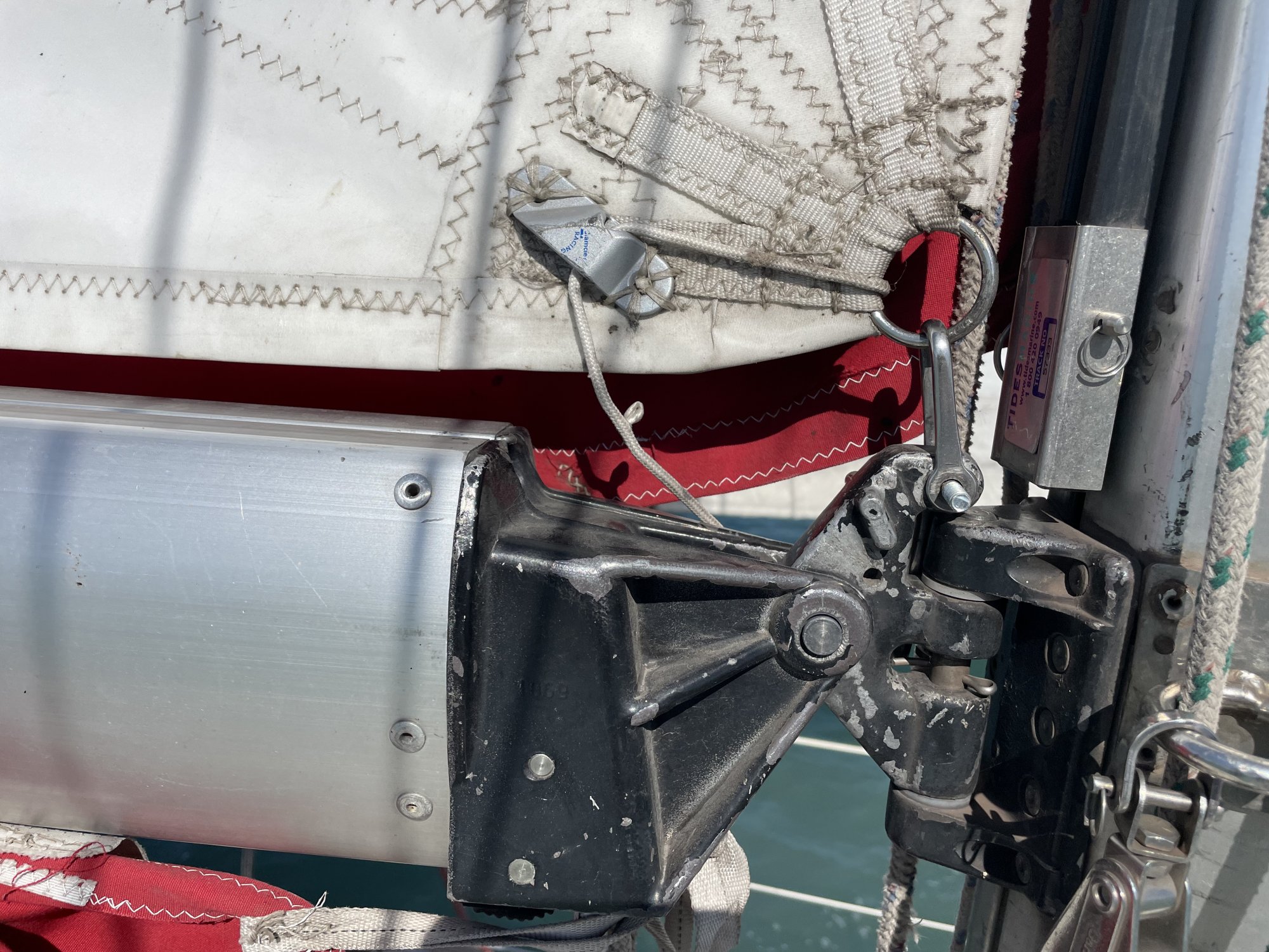

On my O’Day 322, there are a few holes in the gooseneck that I can use for my tack shackle, and I can also put reefing hooks on the pin if I want to…
In this photo, the reefing hook has been removed (and no nut on the bolt)…but you can get the idea. A shackle is through the tack ring on the sail, and secured to the gooseneck.
