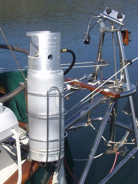

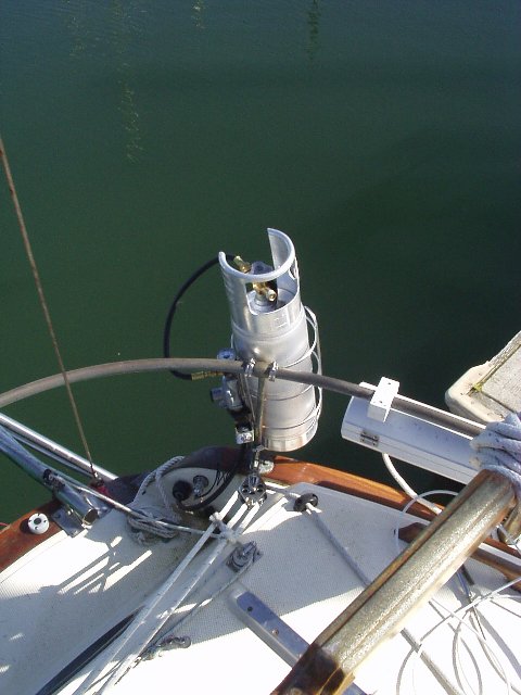

reading this thread with interest, as i have no propane locker currently: anyone add a locker? Sully how are you storing you tank?
We use a SS fender holder on our aft rail......
Works GREAT, NO mods to the boat needed and keeps the gas way off of the boat. As I said in an older post, we cover the tank with a Sunbrella cover to keep it and the lines out of the sun.
You can see the Sunbrella covered tank (just) in the photo below....
Greg
