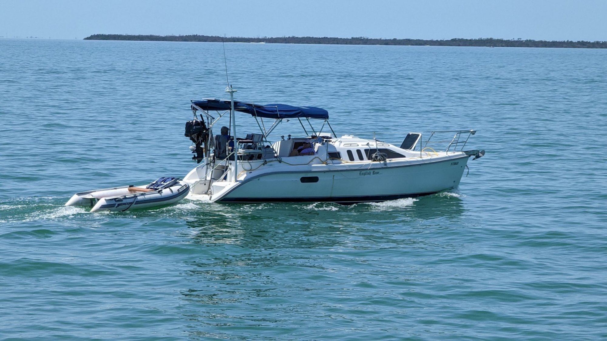

We lost the rig in Ian and now use it as a trawler. We love the comfort for two people. We can go as long as 10 days on the 40gal watertank. Ours has A/c at the dock and we use a window unit and a Honda 2200 fo A/c at anchor. It has a very deep frig/freezer. We had a traveler on the cabin roof, forwatd of the companion way. We had an inmast furler which made reefing easy. The walk out transome made getting in and out of the dink very easy. I felt like the boat was too small for davits so we just towed the dink. Ours backed up like a dream. Just give a short burst of power and coast. I don't know why there was such a limited run of 29.5's

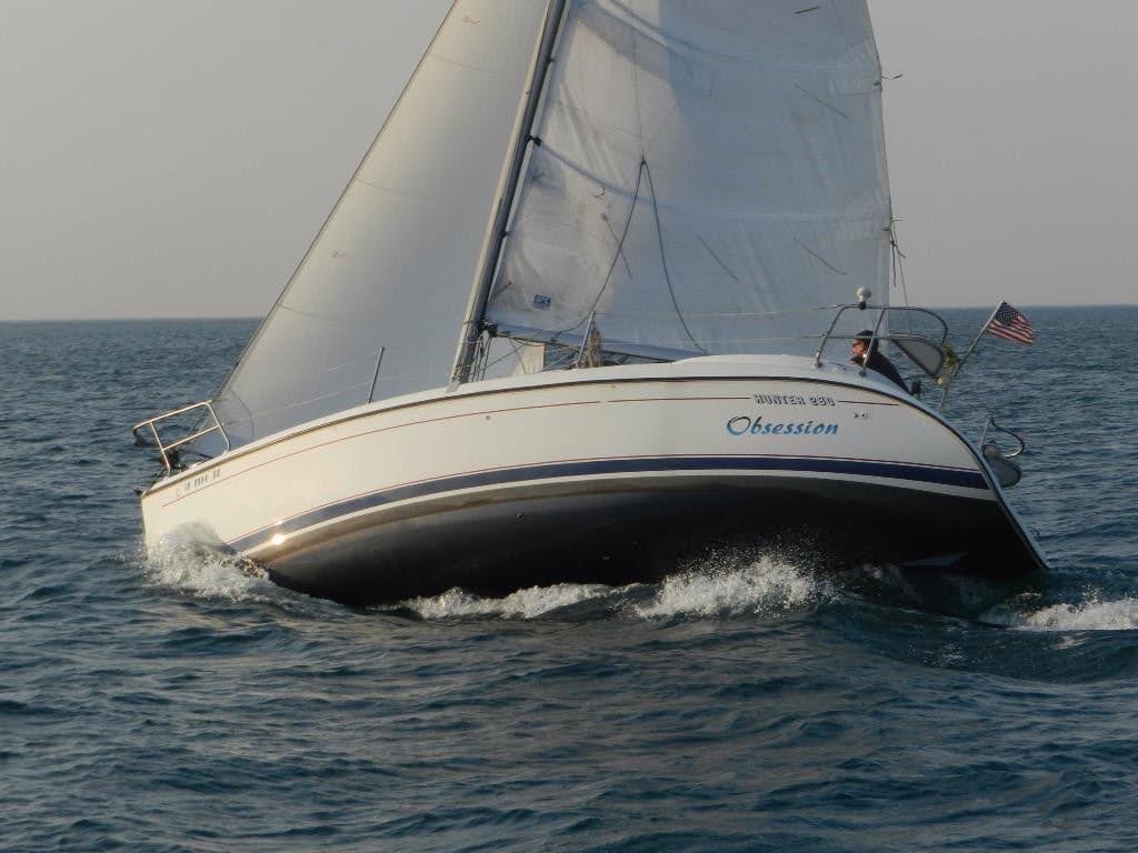

I had a 1998 Hunter 280, which sounds like a similar boat….B&R rig (no back stay), but my mainsheet was mounted on a traveller.
There is no traveller in a set up like that, so all you have as a control is the mainsheet and the vang. My boat also had a rod kicker to hold up the boom.
I liked the boat…owned it for 5 years before finding Tally Ho…
I love this shot… racing a guy back to the marina, way over-canvassed for the wind…but I was having fun.
