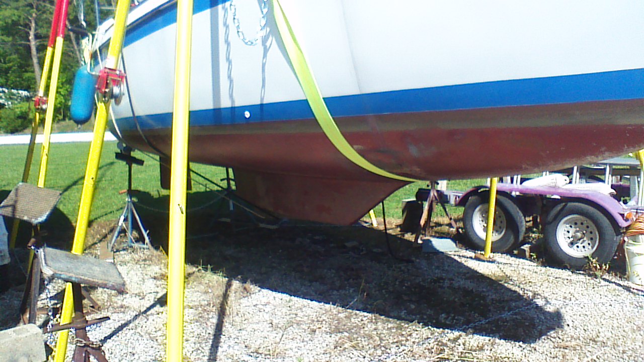

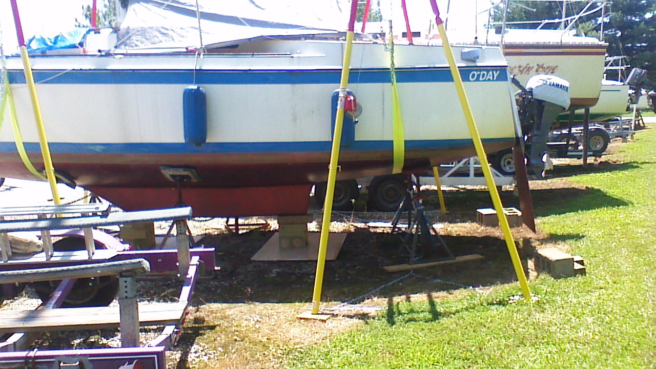

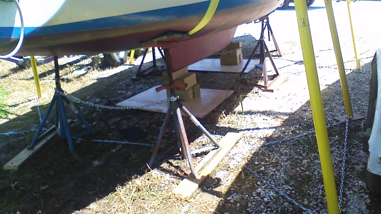

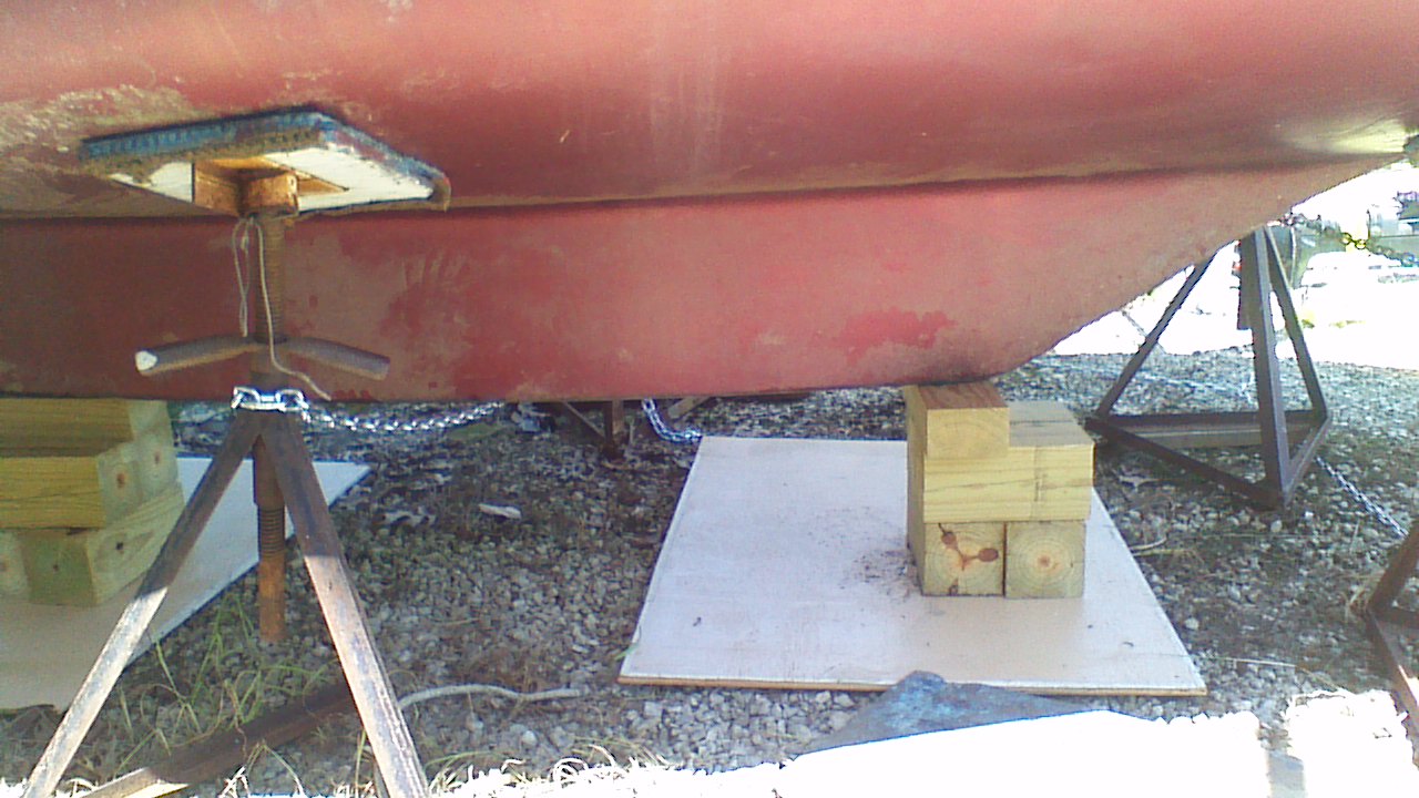

I appreciate all the input and help I have received from this forum over the years.
Last October I posted a topic asking for advice on lifting my O'Day 25 off my trailer to work on my stuck centerboard.
From this post I receive some great advice especially from Kermit & Crazy Dave about using a sling to lift the boat.
Keep in mind I am on an inland lake with few resources. The nearest travel lift has a meter that starts at $500 just to lift the boat and then the meter runs, and runs and runs!
I had a heck of a time begging and borrowing boat stands!
A lot of research on how to do this safely!
I was thinking of jacking up the boat but just couldn't get past the inherent risk of the boat slipping and the damage and injury that might be sustained.
I ended up going with gohoist.com boat lifting unit.
The people I worked with at gohoist were phenomenal! - Thomas Hurner & Charles Bridgman.
The hoist has really worked out well for my situation and has allowed me the time and the accessibility to work on my centerboard problem.
