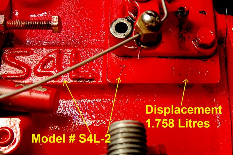

Remove one, scrape off the red paint, and look for the part number. Easy to cross reference. A 10 Two is a Mitsibushi block. Look near the injection pump and you should see KSA2 or similar cast into the block.

Thanks again folks - found the glow plugs through the Mitsubishi K2AS parts catalog - part number y-114t and the price is under $7.00 - that saves me a 1100% mark-up! Westerbeke is robbing us!
