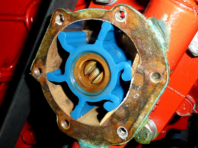

A few weeks ago someone asked about my Globe impeller I had installed. Well, I finally checked on it today.
In April 2011 I installed a new Globe "run dry" impeller in our Westerbeke 44B. We used it last season and I removed it for winterization and it looked ok but with some minor abrasion looking wear at the blade roots. I re-installed it in the spring to see how long it would go.
Well we are getting ready to cruise so I thought I would check on it....
This is about the same as my last experience with the Globe Run Dry. The Johnson 09-810-B1, which is the factory impeller Westerbeke uses, actually lasts quite a bit longer longer than the Globe does, on our boat. It also costs me less than half the price or $18.00 vs. $48.54.
Despite what I consider to be a rather short life, I am going to throw in another Globe, hoping this one is just a fluke. On our previous boat two Globes in a row spun the hubs so I gave up on them for that boat. On this one the hub is fine but the vanes are done in less than 1.5 seasons worth of use?

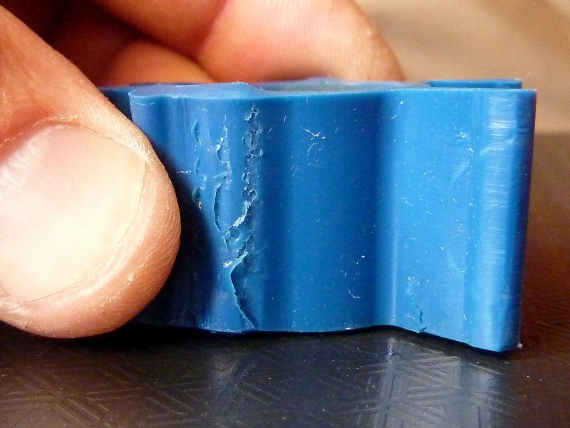

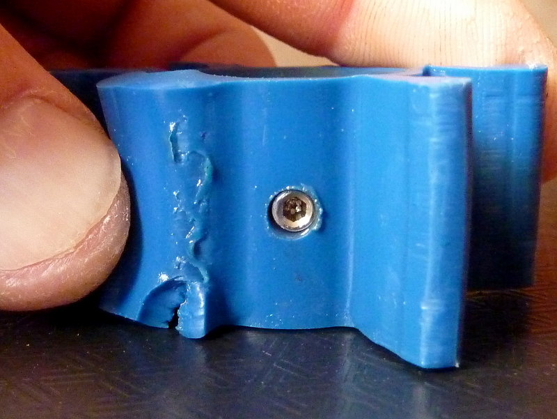

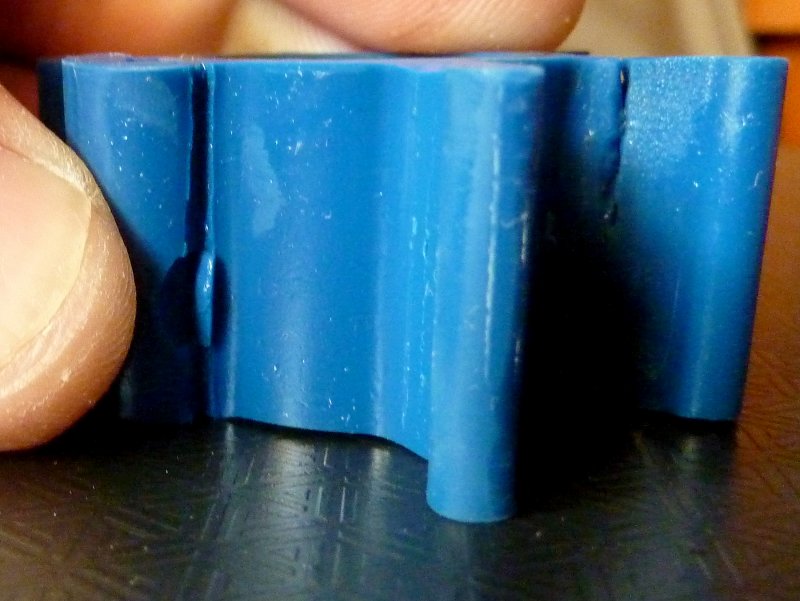

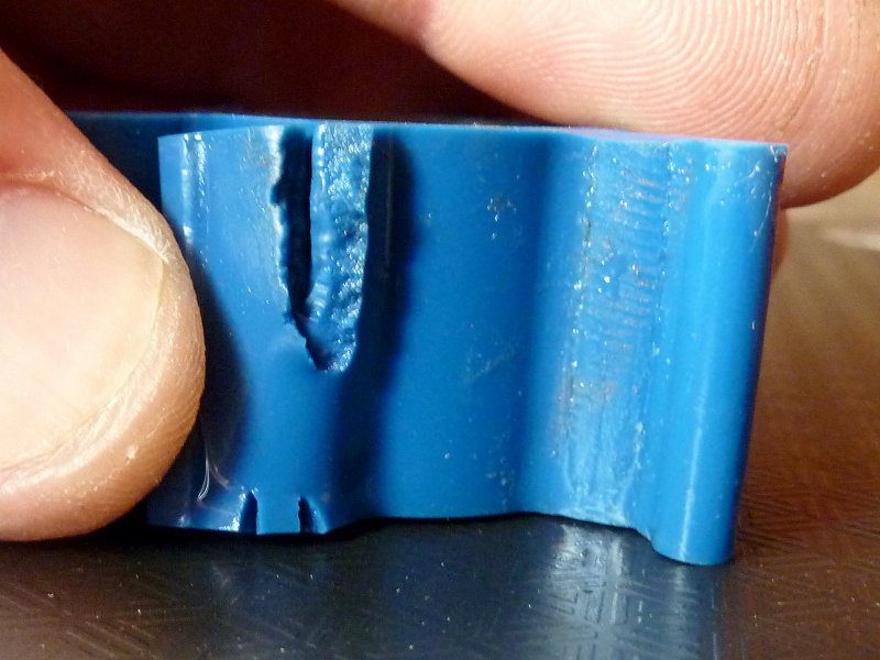

Five out of the six blades are physically cracked and two are nearly ready to fall off. The sixth blade is well on its way to a crack..
Specifics:
Installed April 2011
Oversized raw water intake (plenty of raw water)
Never, ever run dry or even close (but they claim 15 minutes is OK)
Strainer cleaned/checked weekly
Removed for storage & showed minor wear reinstalled in spring to see longevity
Inspected at 141.2 hours of engine use (we have engine driven refrigeration)
Impeller was toast
Engine can fill or suck dry a five gallon bucket in roughly 45 seconds
These are the results:
141.2 hours:
Update Second Globe: The second Globe was dead when I inspected it at 78.4 hours use. This was about half the time it took the first one to fail. Three of the six blades were cracked at the blade root, similar to above.. I have gone back to the factory Johnson impeller.
Update Factory Impeller: Just to see how long the factory impeller would last I did not change it annually (I did remove for winter though). At 312.3 hours use it is still in good shape with no cracking or visible defects. I replaced it anyway... because I already had the pump open..
