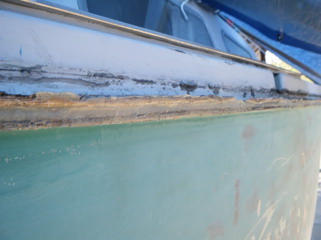

I am glassing the hull deck joint, couple of questions. Should i use more than one layer, my plan was i only needed one layer to do it, and didnt want extra build up to hinder the toe rail going back on, but now i look at the one layer, and its just so flimsly and paper like. Also, i have been packing some fiberglass, and matt into the space, before i glassed it, will that do any good, will it bond, as i cant really clean in there.

If you work carefully you can grind the original parts to a good taper and lay chopped strand mat in resin and get several layers built in and then restore the contour. Mine was glassed inside at the factory but I also glassed the outside to keep water out of the joint.

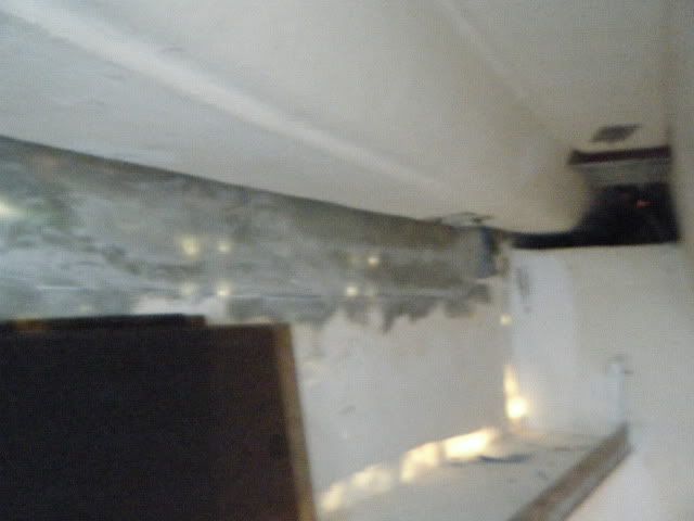

I had thought of doing it from the indside. But i didnt know if i get to every part of the joint on the inside. I was also, usure about what effect, water getting into the joint, then remaining in it would have. I now think what i will probably do, is put one layer on the outside, then put a couple of layers on the inside, and if i get to all the parts on the inside, then its not a problem.
May seem like a stupid thing to say, i am new to working fiberglass, but when the resin cured, it was an extremely solid joint. When i had put it on, just the one layer, i thought, their is no way that is going to be enough. Now i am looking at something that seems extremely strong.
