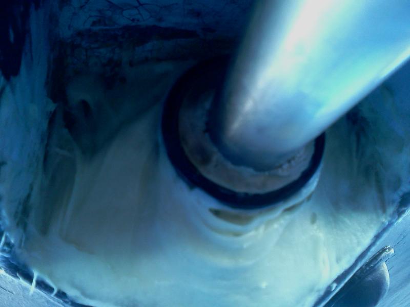

My plan is to "tab" the tube in with everything lined up, take the shaft back off, then I'll have plenty of room to glass it in thoroughly. And I have a PSS dripless shaft seal. Here is what I'll be glassing:

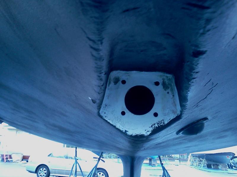

I'm just about done. Didn't use a flange at all, just filled it all in with filler filled epoxy (404) inside and out and then a coat of fiberglass on the outside. In this photo you can see how I tabbed it in. I dry fitted the shaft on and used plumbers putty (which you can see) to hold the tube in place (I used a strong fiberglass tube I found on the internet) while I slapped a gob of filler/resin on it. When it hardened I took the shaft back off and put another five or six applications of resin/filler, grinding down with a dremel here and there. I must say I'm pretty happy with how it turned out. I think I'll be posting a thingy in the owner modifications in a few weeks about it. Have to splash this Monday!!
