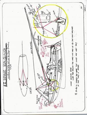

you'll need a pully hanging from the bowrail so the winch line dose not cut rubrail up.For the 25 you need about a 6ftleg s "A"frame or a gin pole,plus make a bridel to keep it from going side to side as it go's up. this pic may help. below
