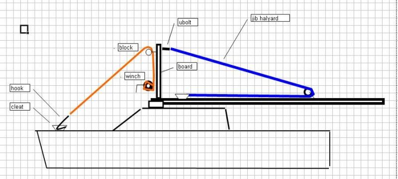

Decide what you want. I wanted to have a light weight strong portable self contained gin pole that can be used on land or water. So I built a self contained stationary pole gin pole with a yolk on the bottom that simply slips over the mast bolt on the tabernacle. A big U on the end of a 6 foot pole equipped with a winch and a block.
A gin pole foot can be as simple as a notch cut into the bottom of a 2x6 that generally fits the mast with a strap around it if you like. It doesn't' necessarily have to fasten to the mast - it can just rest there if you like but its more stable fastened. Once loaded the gin pole system holds it in place.
