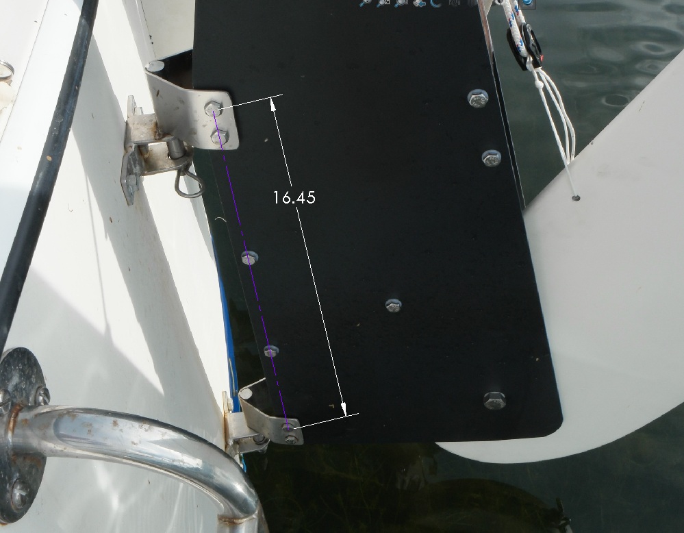

I am in the process of building a mast chruch for my ODAY 222. MY BOAT is over 3hrs away. If anyone is near their 222 and can measure the spacing from the top of the top pintal to the top of the botpm pintal it would be greatly appreciated

I'm not at my boat but I rebuilt my rudder last year so I have detailed dimensions for my '86 222. Center to center dimension of the mounting holes will give you the same measurement as the pintle to pintle dimension. Mine was 16.45" so I'd say 16.5" nominal will work.
