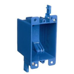

The “original to me” boxes in my boat were electrical standard 3”X2” type with the angled back corners and cable clamps which only have approx 10.5 cu in capacity. The original boxes in my boat were standard Raco metal boxes. These were fine for the old Non GFI receptacles. Raco makes a couple of deep Old Work Boxes; one has approx 12.5 cu in capacity (square back corners) and the other has about 18 cu in cap. The smaller deep box may do the job and you may be able to reuse the protective cover inside the hanging locker. (covers the box on the back side). Both of these boxes are typically available in the big box home stores.
Personally, I used the blue plastic “old work” boxes made by Carlon. These boxes have approx 14 cu in of capacity. These provided the extra room I needed for additional wiring to extend the starboard circuit forward. I added another receptacle in the shelf behind the dinette and a utility receptacle inside the lazarette. Being plastic, the Carlon boxes do not rust (except possibly for the screws) and are also available in the big box home stores.

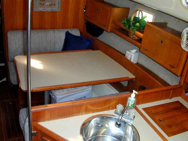

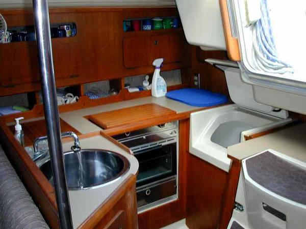

Glad you were able to find boxes that worked. Yes, the original wiring plan only provided one recept on the stb side. It's the one in the galley area. See pic below. Sorry, the pic was taken right after I bought the boat and does not show the GFCI.
As I posted previously, I installed another receptacle in the stb side shelf in the dinette area. I tapped into the existing galley receptacle and used PVC couduit to provide a secure chase for the wire from the lazarette, behind the the ice box, oven and cabinet into the cubby hole next to the aft dinette seat. The wire is then routed on the bottom of the shelf into the cubby space underneath the dinette table. I mounted the box and receptacle in the shelf, centered on the table. It provides a nice place to plug in a small shore power table lamp and other items, phone charger, computer, etc, etc. Again, its an old pic, but the new receptacle is right where the tissue holder is in the second pic. Looks like I need to take some new pics of the interior.
