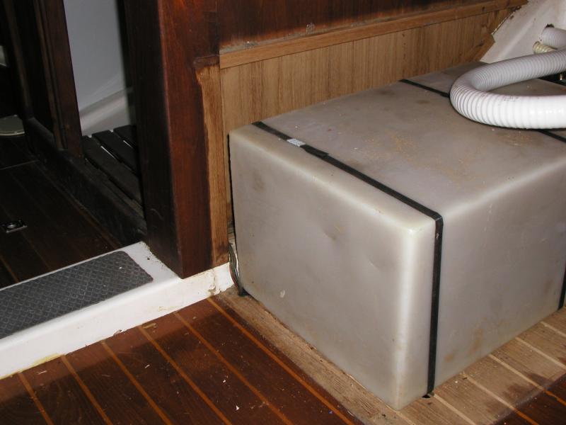

There is at least one hole through "the bump in the floor" that the hose to the holding tank from the head passes through- it is near the outside (starboard) end of the holding tank. There is probably room for a wire there

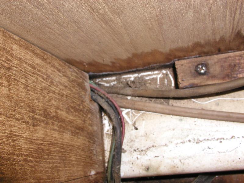

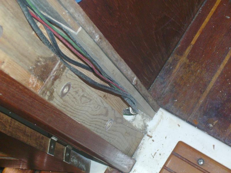

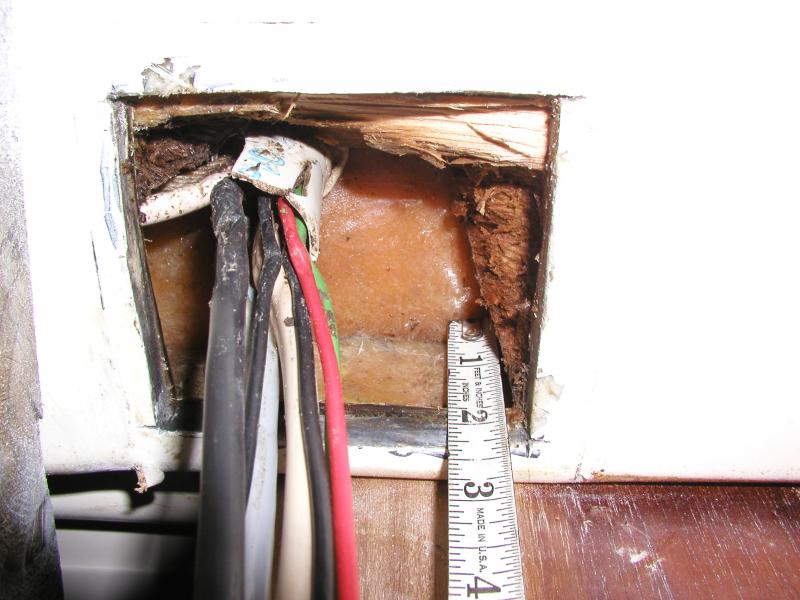

10,116
H-34 Mast Wiring
Herre are a couple of shots of the wiring in my '85 model.. The antenna wire, as Claude and others say, comes through deck then runs to port side through the beam.. On my boat the mast lights and wind instrument wires run down the post and then under the floor aft.. One picture (with the tape measure) shows the white antenna wire going left of the batch that go down the post.. other pictures show the wires (mast head wind and lights) exiting the post at the floor and going under floor..
Sep 21, 2009
385
Hunter 34 Comox
You won't get anything through the bottom rib. There is a solid piece of wood in the middle where the mast post sits. There are wires and plumbing that run from side to side just in from of that rib under the sole. You might be able to use and existing wire there as a pull string.
