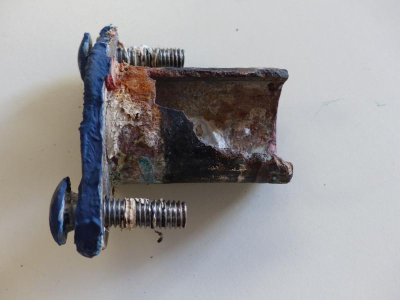

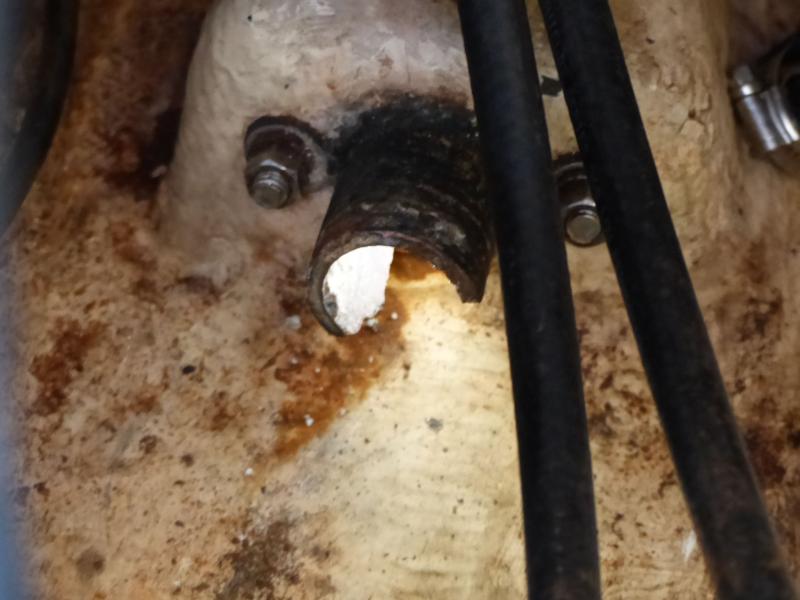

My '84 is 1" also. Just replaced cutlass bearing. Related, as I was changing out packing gland, discovered cracked stern tube. Brass was much thinner and softer on bottom and lower quadrant fell off as I touched it (see photos). Anyone experienced this? Misaligned shaft or just 31 years of oxidation?
is that steel that its made out of ...if so it lasted a lot longer than i would have expected
i really don't think it is steel ...it could be that misalignment was the problem causing undue wear

Looks like brass to me. I will definitely check for alignment when reinstalled.

Wow you were lucky to find that. Is the shaft worn where it passed through the stern tube? I beleive it is made of bronze, not brass. There seems to be some pink color indicating a loss of zinc in the alloy. Was it electrically connected (bonded)?

Amen, While I regret another week in the yard, small price to pay. Shaft shows no sign of wear where it passes through the stern tube. Yes, bronze makes more sense and shows the same pinkish color I notice on the strut holding the cutlass bearing. I change zincs frequently. I don't believe the stern tube was bonded; no evidence of connection to the boats bonding system. But I'll add it. Thanks, Allan.

Actually I was thinking the shaft if rubbing was in effect bonding the stern tube and that was the reason for the deterioration. So, I don't know if that is a solution or not. My stern tube (not bonded) looked good in October when I hauled and changed the bellows on my PSS dripless system. My strut also isn't bonded and a long time ago when I saw it getting pinkish I drilled a hole through it and installed a flat pancake zinc rather than bonding it.
