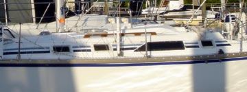

I have some old stripes that are on my boat and I want to take them off. They are pretty old and are waring through in places and cracked in other places and faded. I have read about erasers that you put on a drill and some folks have said to use a heat gun and scraper. I just want to take them off as easy as possible and not hurt the gel coat under them. I haven't done this type of project before, so I am looking for all of your responses to hold my hand and walk me through it. Thanks in advance for all your help. Capt. Paul s/v Magic Wind 1986 Hunter 31' Hull #714
