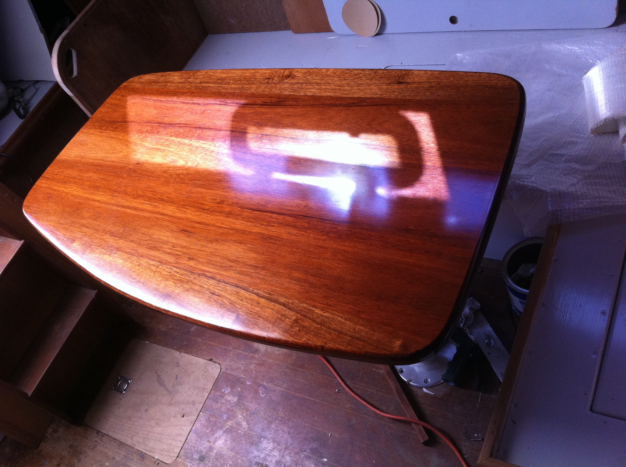

That looks awesome, How do you apply your oil? My interior woodwork soaks it up like a sponge. looks good for a day or two, then starts to fade, and dull.
i just painted it on and let it dry for a full day then rubbed it with a scotch bright pad and wiped the dust and added another coat....did it six times oh and i used a wool sock to apply the teak oil

My oil-finished teak furniture looks like Woodster's table. I used Watco Teak Oil, too. I say used because after a few years of twice-a-year application, my wood won't soak up any more teak oil. The teak oil hardens when it dries, so make sure to wipe off the excess while it is still wet. I used 0000 steel wool to apply and cotton rags to wipe and buff. My everyday kitchen table is teak and seems almost bullet-proof; does not stain, no water marks, etc.
WARNING: Do not try to put an oil finish on wood that has been previously sealed with lacquer or other sealer.
