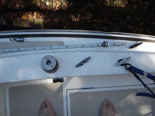

I am getting close to reinstalling the deck hardware on my OD22. My 22 has been outfitted with genoa fairlead tracks with movable cars. This is a great addition and helps quite a bit with trim. However, as originally installed (either by O'Day or the PO) the track extends very far aft, about a foot and a half short of the transom. The problem with this (maybe a problem?) is that the winch is well forward of the fairlead when it is in this aft position. The fairlead is often in this position as I have a 155 genoa, which does best to weather with the fairlead far back. You can maybe visualize the issue that I have when I bring the sheet from the aft fairlead, forward to the winch, and then back to the cleat. On the starboard side this creates a situation in which the genoa sheet crosses over itself as the bitter end leaves the winch to the cleat. On the port side the line does not cross itself (b/c of the direction of winch wrap). Should I install the track more forward and sacrifice some of advantages of having the fairlead aft when going to weather? Should I mount the winches further aft along the coamings? Thanks in advance for your help.
