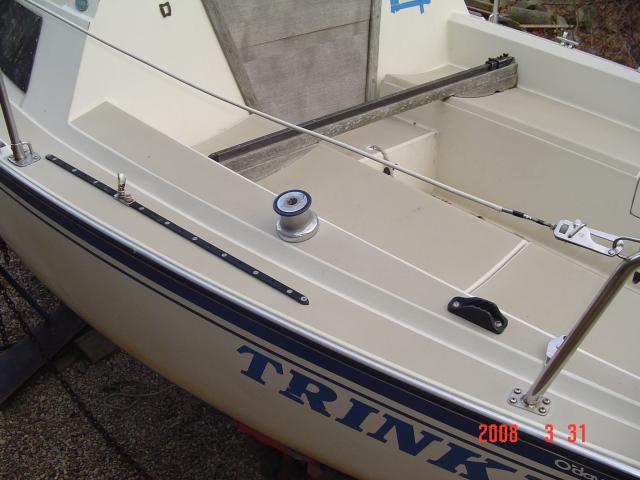

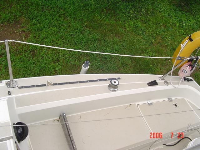

In the real world, the sheet angle from the sheave should cut the luff of the Gennie in half with an imaginary line. So if the sheave is too far aft or too far forward, it's going to be in the wrong position. Greg is right. You need to get rid of those pad eye blocks and install some tracks so that the cars can be in the right position for the Gennie whether it's all the way out or reefed. When I bought my 1986 O'Day 222 new at the Boston Boat Show, I asked the dealer to have O'Day leave the winches and tracks w/cars off the cabin so that I could relocate them to my combings which I did myself. Fortunately I put them in the right place because years later I'm able to use my CDI in all the favorable positions. Back then I think that I took my boat out on the lake on a light air day for a dry run and marked the position of the placement of the track with the mark as the center of the track. The boat came with a cheap Schaeffer roller furler that was only used for rolling and not reefing. I later removed it and went to the convention hanks on the fore stay and reef points on the Gennie "a la Lynne & Larry Pardey style." :) There is one thing that I never regretted doing to my boat that was an idea I picked up from an old magazine out of publication now called "Small Boat Journal", and that's to install a large open clam cleat behind each of my winches for snubbing off the sheets. Two of my friends at the club have adopted this idea on there boats and they love it. One guy sails an O'Day 26 and the other guy sails a Seaward 22.

I like the suggestion for the open cam cleat as well- fast and simple, and in line with the line of pull. My current configuration is a joke with he car being behind far aft of the winch, the horn cleat being between the winch and the car, and nothing but headaches when trying to fine tune or make a quick change. I singlehand frequently, and have always been frustrated with the way things are set up right now on the boat. Time to make the change!

I meant to write an open "clam cleat." Pardon my typo. I just corrected it on that other entry. They also have self rescue clam cleats in which the rope runs through a hole in the cleat. I have two of those on my tiller for my tip-up rudder pendant lines. I use one to hold the blade down when I'm sailing, and one to hold it up when the boat is in shallow water.
The one thing that I regretted doing was to install a Herreshoff Cleat on the Starboard combing just before my Gennie winch for my CDI Roller Furler drum control line. Big mistake! Every time I went on a Port tack, the luffing Gennie would cause the Starboard sheet to get caught in this cleat. The week that Hurricane Earl was headed toward Massachusetts, I pulled my boat out and brought it home and got rid of that cleat. I also pulled part of my Port gunwale strip off and re caulked the area where little drips of water was getting into the cabin.
I haven't decided what to use in place of this cleat as of yet, but whatever I use will be located somewhere near my stern rail. Live and learn. Good luck with that Paul.
