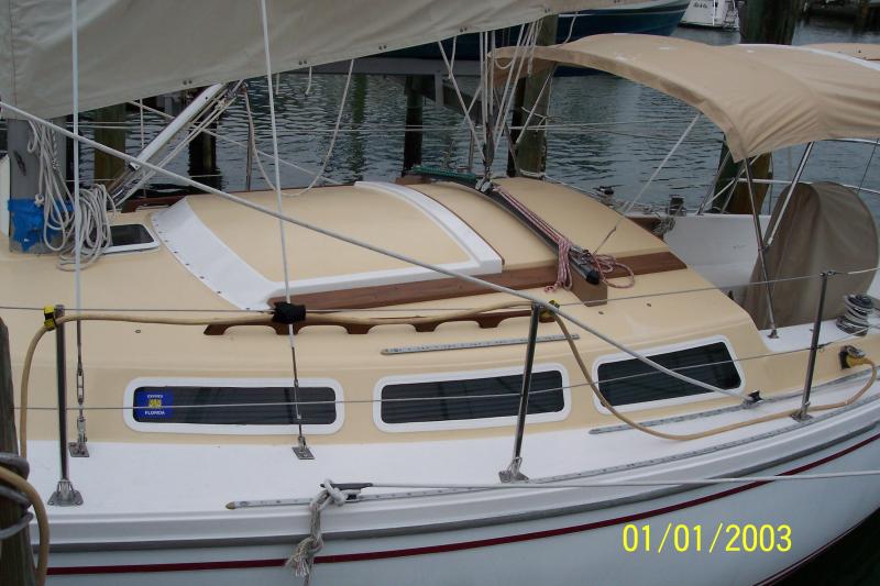

I have the toerail track which extends back to almost the last drain scupper. Using 3 different sails was never a problem. What I didn't like with this outside track was not getting an optimal shape.
So I installed the interior track. the pic will show where I located my curved track (not straight like on the later designed Cat 30). The attached pic is for comparing your track location relative to mine. Note my ginney sheet running thru the lifelines. From full deployment to shortening furling points, I have not had any problems with lifeline interference. Of course I move my cars for shorter sail sets. I would try moving you cars to different locations to see what works best for you.
Your note about hanging up on your stanchion, I thought about a couple of reasons based on my earlier experience. You should never unfurl the head buy just letting the furling line run out free. I am lucky as I have extra winches(as shown in the pic) where I make a wrap for my furling line before the unfurl begins. This friction better controls the speed of the unfurling while at the same time, allows me to start cranking up on my sheet while the sail is unfurling. This way, I control both lines from flapping and also the sail. Maybe this method will work for you. Hope this helps pal.
