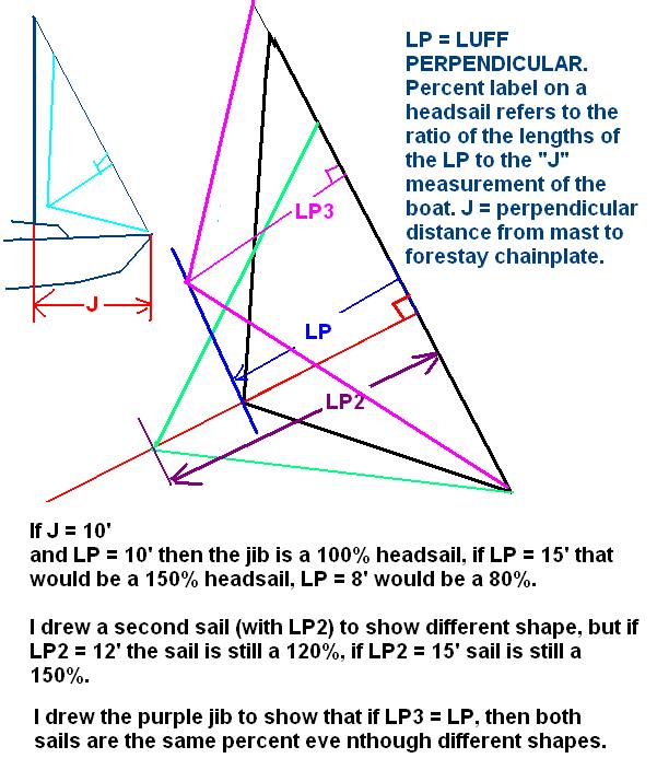

I may be mistaken, but I thought the % was figured with the length of the line perpendicular to the luff through the clue, not the foot (that would be too easy :) ).

Quick & easy way to do it is: Spread the sail out on lawn and pull it flat, take hold of the tack and fold the the luff back along itself until you get a fold running perpendicular from the luff to the clew, pull everything snug and flat, measure that length (the girth measurement). Divide that by the 'J' measurement for your boat and the result will be the % of the genoa.
