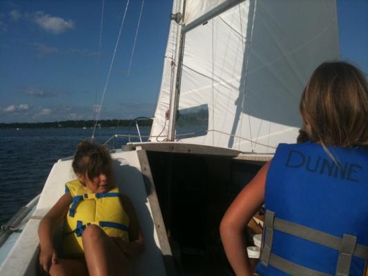

I've been having issues with the genoa on my boat. It is a 150 with a window in it. It seems to be very low to the deck sweeping across and hanging up on anything and everything with each tack.
The sail doesn't seem to hang right either, not filling properly unless I leave the sail looser than I'd like.
Being a novice to the C22 and at best a intermediate sailor I'm at a loss. It looks as if raising the sail another 6-8 inches up the stay would help. Any ideas?
I will try to add pictures a little later to illustrate what I mean.

It appears that the PO had gotten a sail from a smaller boat.
With the sail up I'm about 3' from the top of the stay.
I say that the sail doesn't fill properly in that it rolls over unless loaded with a lot of wind.
As for the Genoa cars I've been moving them forward and back looking for the "sweet spot" where they seem to work best.
More than that I do not know. My real world experience is limited to blue jays, lazers sunfish and my puffer beyond that I've crewed on my dads boats but never set one up.

Hard to tell, but the pic seems to indicate a couple of things. The scallops between the hanks and the wrinkles make it seem like you could tension the luff a little more. The direction of the wrinkles makes it seem to me like the leech is over tight (jib car too far forward). If you had a photo of the entire sail it would be easier to diagnose. I'm no expert, but you might get some more feedback if you posted this on the "Sail Trim With Don Guillette" forum on this site.
