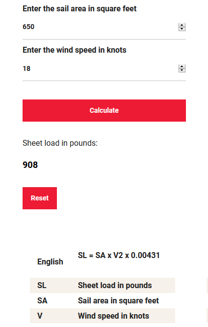

From the Harken website:
Your Genoa could be bigger as the 650sqft is from the newer 50.
