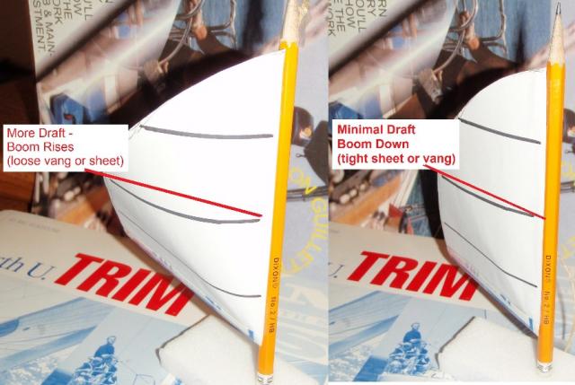

If I understand RichH:
1. Let the boom rise to induce twist beyond what the wind gradient calls for and you add draft in the middle of the sail. Hence, power is added and the boat's heeling is harder to control in a gust It also becomes more difficult to keep from flogging the main sail.
2. Set twist for the wind gradient - i.e., so the main leech telltales flow most of the time.
3. In a gust, blade out with the traveller so that draft is not increased in the middle of the sail.
I attached a cartoon sail that I made from a sheet of paper - I think it shows what RichH* was saying about draft INCREASING as twist increases when the boom rises.

I'm trying to picture what would happen to the draft depth if I let the boom rise as high as it wanted to. I still think the set of the sail would be so out of shape to be ineffective.
I agree with you here - hopefully my sheet-of-paper cartoon pictures in the post above show the effect that you are talking about here.

Old Cat... nice try, I get it. Just remember, the paper is FLAT... sails aren't.

Different authoritative sources sometimes conflict. If you look closely at my paper sail 'artwork' you will notice two sail trim books in the background. Don's and the North Sail book. Don's is easier to start with. As a matter of interest here, the North book states something to the effect that light fast boats vs. "lead mines" need a different approach to blading out vs. twisting off.
