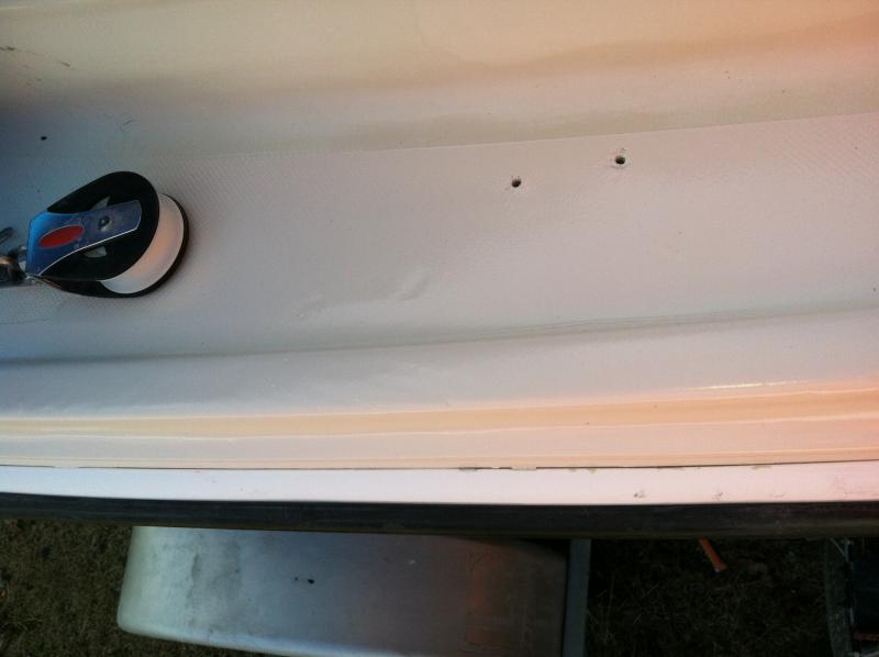

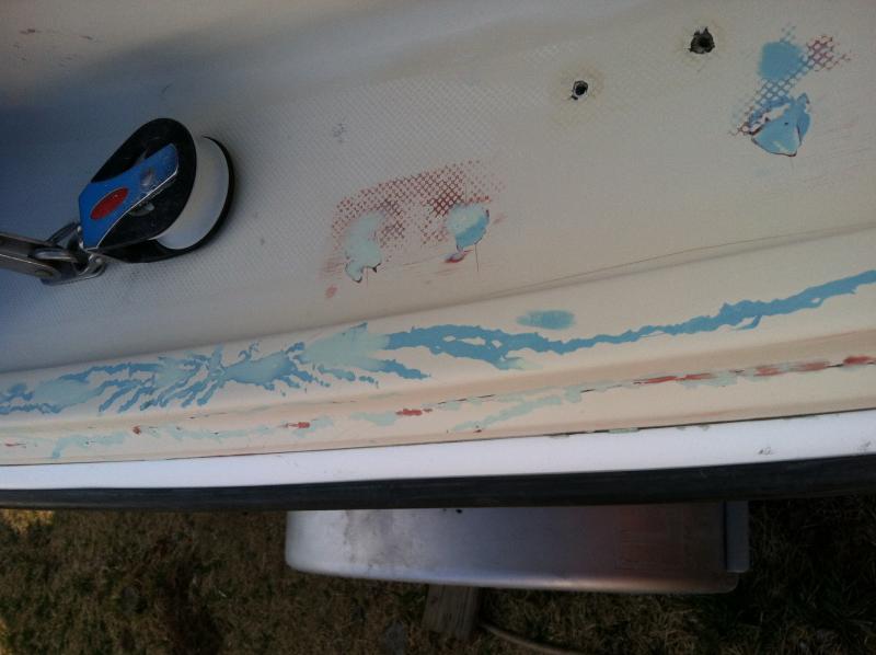

I recently made some repairs to my toe rails. I think one of the previous owners played bumper boat on more than one occasion.
I ground the spider cracks with a dremel and filled with 3m premium filler and a little bit of Bondo cream. I used Brite white finishing gelcoat. My boat is more of an off white so I added 2 drops of brown tinting agent to every 2 ounces of gelcoat. I thinned the gelcoat with acetone, approximately 10 percent. I shot it with a cheap Harbor Freight touch up gun.
The gelcoat laid nicely, little orange peel. I only shot one toe rail. I eventually need to do all of them. I think the gelcoat was a decent match. It will blend better once I wet sand.

The above pic is a section showing the filler work. The 2nd pic is the same area after shooting the gelcoat. It still needs to be wet sanded but looks acceptable as is.
