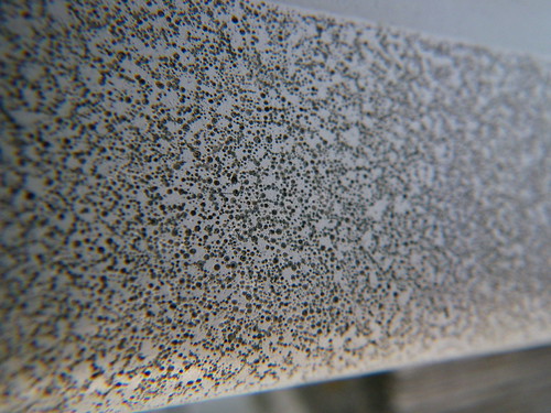

I have about a 2' by 1' strip of Gelcoat in the cockpit that looks terrible.
This is a macro shot to see how pitted it really is.
GelCoatPitting1 by picndicular, on Flickr
Any suggestions to fix it up? I have no Resin/Gelcoat/Epoxy experience but you got to start somewhere. I know matching colors, even white is about impossible but I feel like if I don't do anything it's just going to get worse and worse.

Wow. Do you have any idea how that got that way? The indentations look too deep for using even rubbing compound. I'd start with Collinite cleaner, a liquid light abrasive compounding-type material. If that doesn't work, get some more abrasive compounding, like basic rubbing compounding from an auto store. I'd start on an area "out of the way" if you could. If not, it might be worthwhile to consider acetone or paint brush cleaner to get the bad color out, and then re-gelcoat the "refinished" surface.

Actually I would start with some Totally Awesome from the Dollar Store and just see that it does/does not do! This looks like non-skid!
Could this be a patch from a previous owner?

That was there from the beginning - you may have exposed it more after polishing off the outer layer. My understanding is that this happens when there is too much catalyst, solvent, or something else getting in the gelcoat. Only way to fix (if its really bugs you) is to sand it out and put new down - but you are likely to have to sand off most of the gelcoat in that area - is it really worth it?

Oh wait - You said 2' by 1' - I was picturing 2" by 1" - Nevermind - totally worth it ;-) Just have a good gelcoat shop match the color for you - Not worth trying to do it yourself. I've been trying to for 20 years on many projects and have gone through many gallons of gelcoat trying to match color and can come close, but can never get totally there. A good shop can do this quick. You can send a small plug to GCP here in Seattle and they will nail the color match for you - Plug only needs to be a couple inches in diameter - maybe less.

It's a strange thing. Like I said it's about 2' of it and it sorta just fades away to less and less and then none at all. This won't be any project I do right away but I would love to sand it off and add new gelcoat. I guess if I could get them to match the color I could use it to fix little scratches here and there. Thanks for the GCP tip.

I'd just fill it in with epoxy primer, paint it with a decent topside paint, and put a cushion over it. Gel coat is a nightmare.

x2....or even a good epoxy cement floor paint and then a topside paint...
i have had good luck using interlux two part epoxy for most everything i do over gelcoat

What you have is a total degradation of the gelcoat exposing the fiberglass substrata beneath. You have two options: 1.) sand off the remaining gelocat and repaint or 2.) sand off the remaining gelcoat and re-gelcoat. If you lack skills, option number one is your best choice. Good luck and good sailing, Ron
