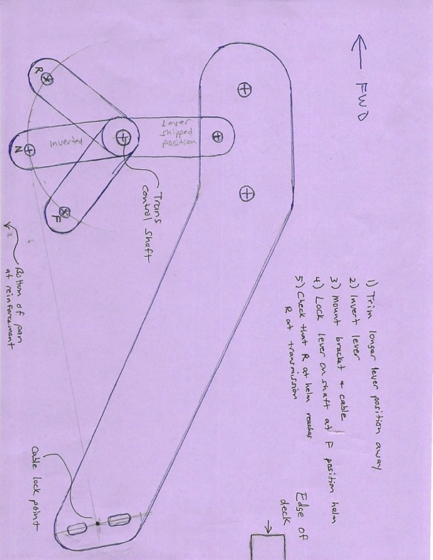

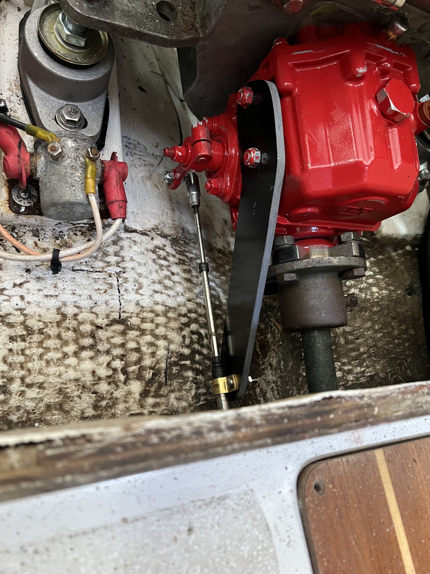

I recently replaced my HBW-50 with a Twin Disc TMC-40. The motor needs to be raised 1/4" and the shaft coupling will need to go back a fraction of an inch. My motor already sat near the top of the engine mount bolts so I put 1/4" spacers under the engine mounts.
The other mod is the shift lever bracket. It is on the opposite side of the tranny, which reverses the action of the shifter. It's an easy fix. The shift lever on the tranny is pointing up as received. Loosen one bolt, turn it so it points down. Then make a new bracket to hold the shift cable in alignment. There is a bracket sold but it doesn't hold the cable in alignment with the tranny shift lever pointing down.
I made my bracket out of 1/4" G10 board using a small skill saw and belt sander.
My tranny rebuilder would only rebuild the HBW-50 with OEM parts. He's had too many returns with after market parts due to their poor quality. My research came across several postings from owners who went the rebuild route only to have it fail in 1 to 2 years so I chose going with a new tranny.
There is also the PRM 60 tranny which has the same specs as the TMC 40. I've read several threads of owners installing that tranny. A suggested supplier is in Everett WA. When I called and talked to him, he said he stopped selling them because of too many returns for odd noises. He is the one who pointed me to the TMC-40.
Here's a photo of the installed tranny with the bracket. Also the bracket template. I've also attached a PDF file with notes on the differences between the HBW-50 (ZF-5M) and the TMC-40.
