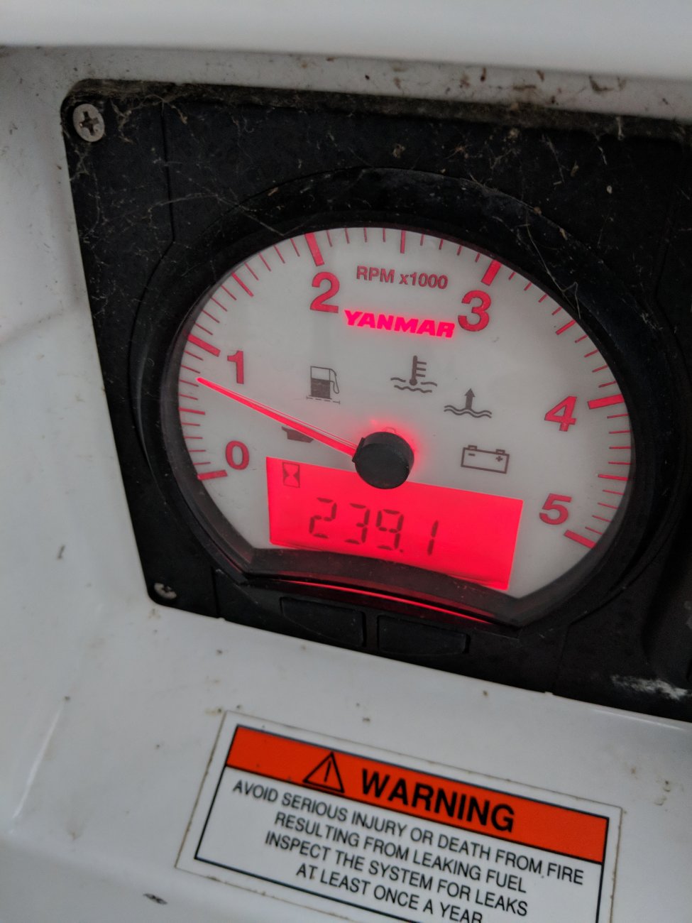

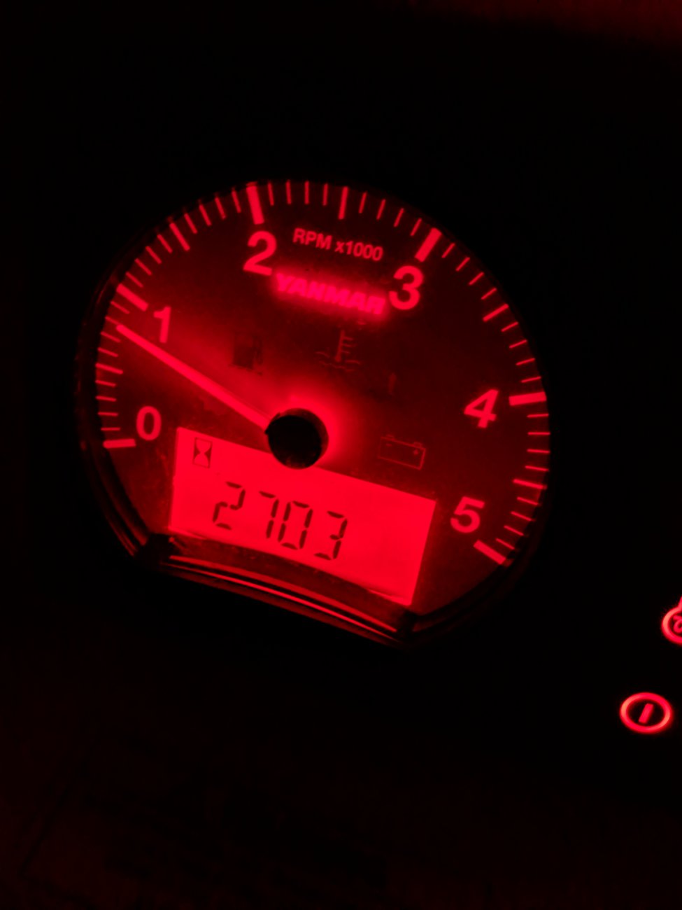

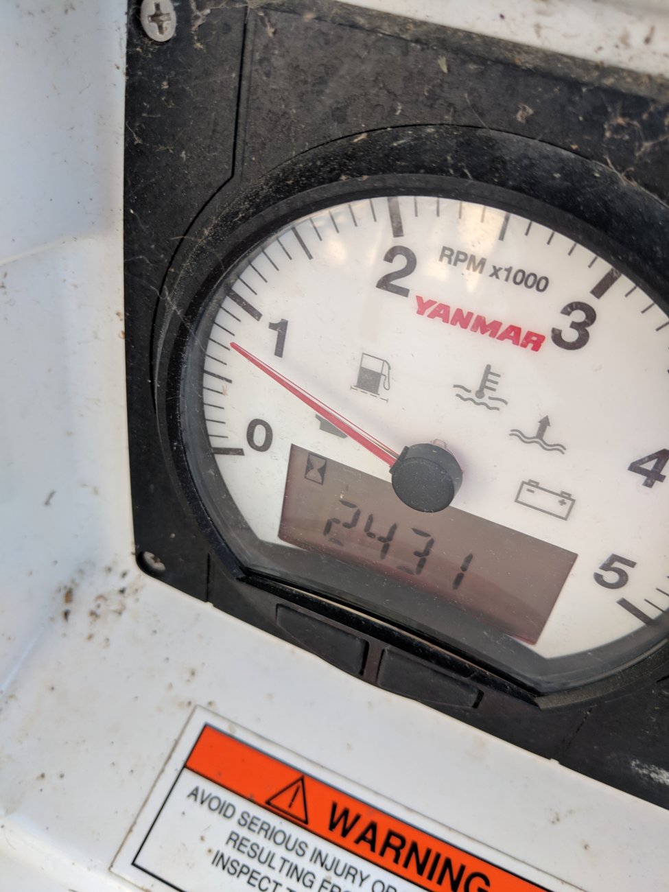

This is our tach, which has white background and red lights. At night time the fact that it's a white background doesn't really hurt night vision, since it's not emitting any white light.
Same dial at dusk -
And during the day -
Our tach is down by the floor, so it can't be seen from off the boat. I never really thought about whether one mounted higher up could be confused for a nav light. My guess is that it's dim enough not to be visible by very far.

Thank you @Davidasailor26 that helps. It looks pretty easy to read day or night.
I see you have the lcd clock version. How do you change the data displayed. Is there a toggle? What size is the tach 4in diameter?

If you look just below the dial there are two buttons, to scroll left and right through data items. We never really use those though. From what I remember the other items are battery voltage (also on our chartplotter at all times) and coolant temp (not wired by Yanmar). I think it is 4", and yes it is pretty easy to read in all conditions.
