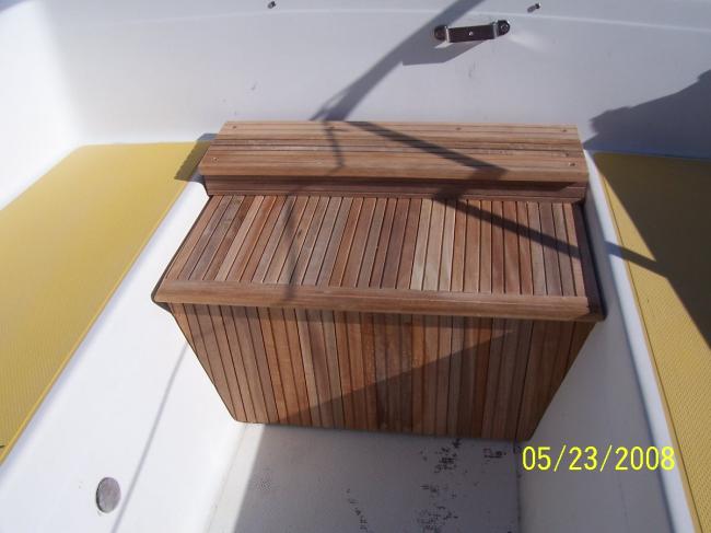

MacGregor 25 KEUKA lake NY
I had some leftover flooring that I put down for my brother and thought I could use it on some projects for the boat.

Does the vent-drain go directly overboard to atmosphere? Looks like it. Top opening, that's another one, you got that. One more is a gasket to make it vapour tight at the top lid to be in full complience with the standards. Lid must be readily accessible (can be opened easily without tools), cut-off valve, and pressure dials must be easy to reach too.

Looks good to me. Please clarify to some that
you mean a gasoline can and not a propane tank. Gasoline vapor is heavier than air so the drain must go overboard. Vent the box before smoking.

If the top lid is vapor tight how can vapors drain by
gravity if air can not enter to replace the gas vapors? The lid should not be secure or sealed if you expect the locker to contain and drain the vapors. Should an ignition occur you WANT the lid to blow off. Mr.DuPont realized this a few hundred years ago and his powder mills were massive masonary structures facing town and light wood construction facing the river. In that way if they had an explosion the blast was directed away from town and out over the river.

Polyeurathane can't deal with expansion and contraction
of wood through our northern winters so well and will pull up. Not sure about straight eurathanes though. Cetol is a good bet though. Their Natural Teak covered with their gloss should do the trick. Watch out for that CapnRon character, he can be funny but seems to know the ABYC standards somehow! Nice work.

I think there is a gap at the cockpit sole to let water in
should it also want to drain out the scupper. I am not an ABYC standards person so I am not sure what to make of it. If it blows, the cover will go first as Ross pointed out. Still looks nice, but having gasoline on a boat is always a concern.

The flooring
is some kind of honduras cherry( I believe it is) It is a hardwood I know that for sure. This flooring comes in boxes of various lengths, and you piece them together. I'm planning on taking this apart after each sail, and place down below. The framing will support itself and I will have two screws holding it down so it won't tip over during heeling. When I'm done sailing, I will pull two screws and put down below. Captian Ron, I don't know what the hell your talking about, sorry! Mac

This wooden cabinet is going to hide a 3 1/2 plastic gas tank. Before, the tank just sat there and I also needed a table top to put some food on and my beers! Sorry if you upset, but hey, least you vent. Have a good one. Mac

The question
that I asked was, if Cetol or Man o War would work better on this wood. As for going psycho Ron, for saying "what the hell are you talking about" I really didn't know. I'm new to sailing (one season and can't wait to get out)and when you threw those comments out, I was lost!! Maybe I should have posted this over at Macgregors forum, they would probably appreciate it more. Thanks guys. Mac

Regardless of the wood Cetol will hold up better than any tung oil traditional type varnish in the marine environment. That being said Man-O-War will look better Cetol but will require LOTS of coats, 8-10 min, for maximum durability while Cetol will require 3. Also Man-O-War is not really considered a top quality marine varnish. Epifanes, Interlux, Z-Spar and many of the other brands actually have track records in the marine environment that Man-O-War can't compete with. Man-O-War might be good for your front door but if I had to choose for durability it would be Cetol and for looks Epifanes...
