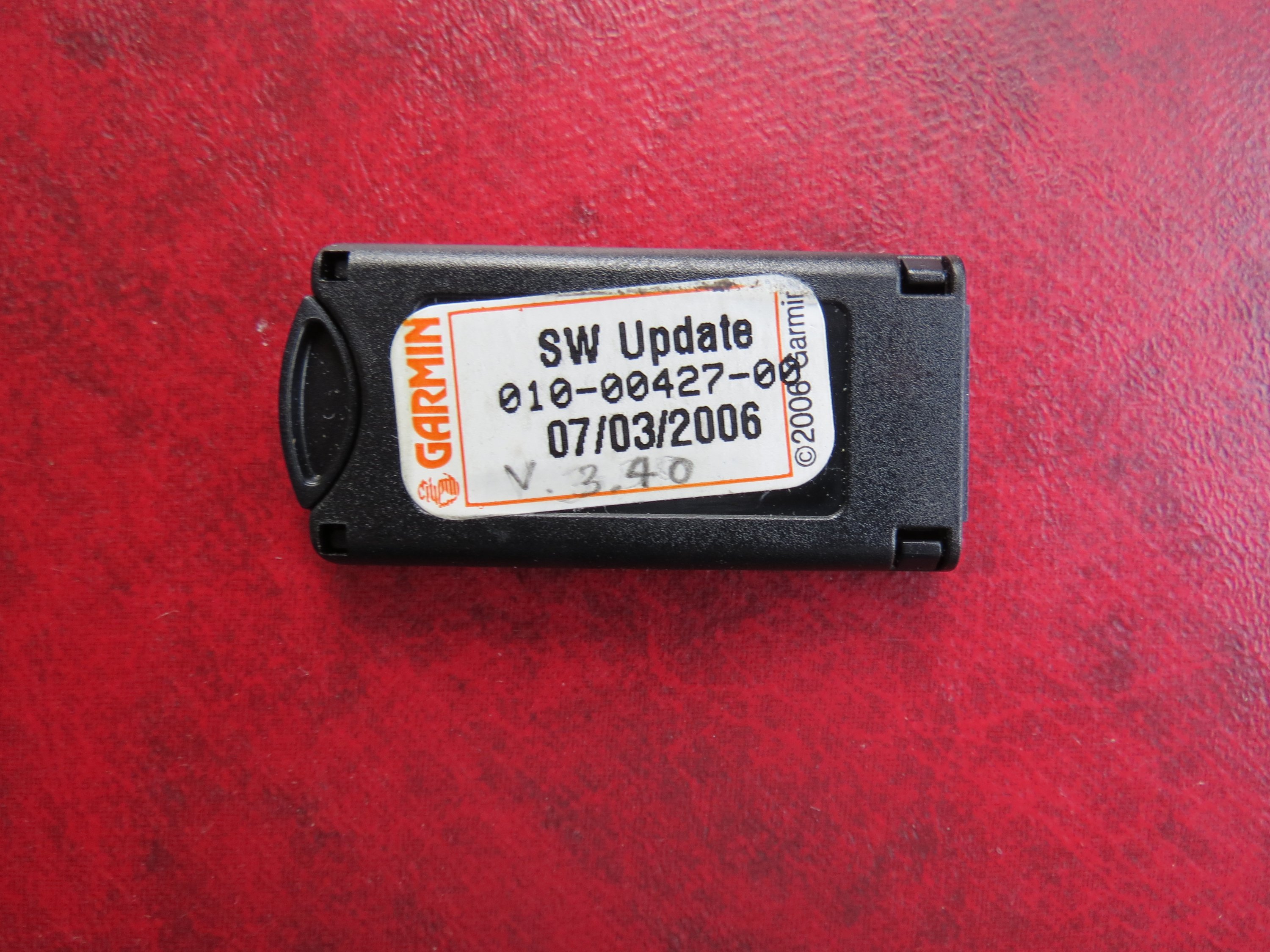

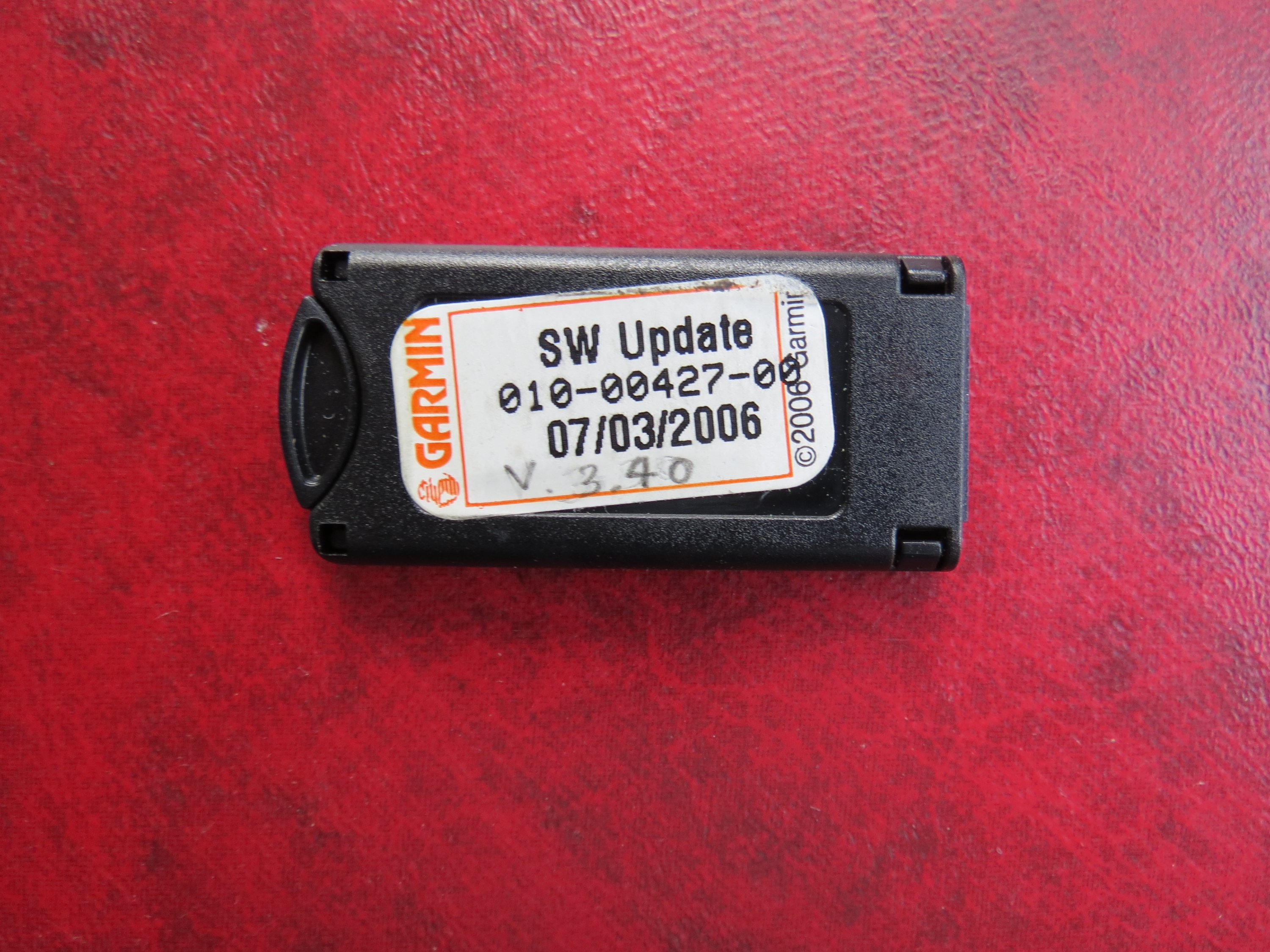

I have a Garmin card for my GPSMAP 492 with the latest SW version 3.40. My chartplotter is the same as yours except you also have the sounder. According to Garmin, SW v3.40 is the current version for both the 492 and the 498. PM me if you want to make an arrangement.

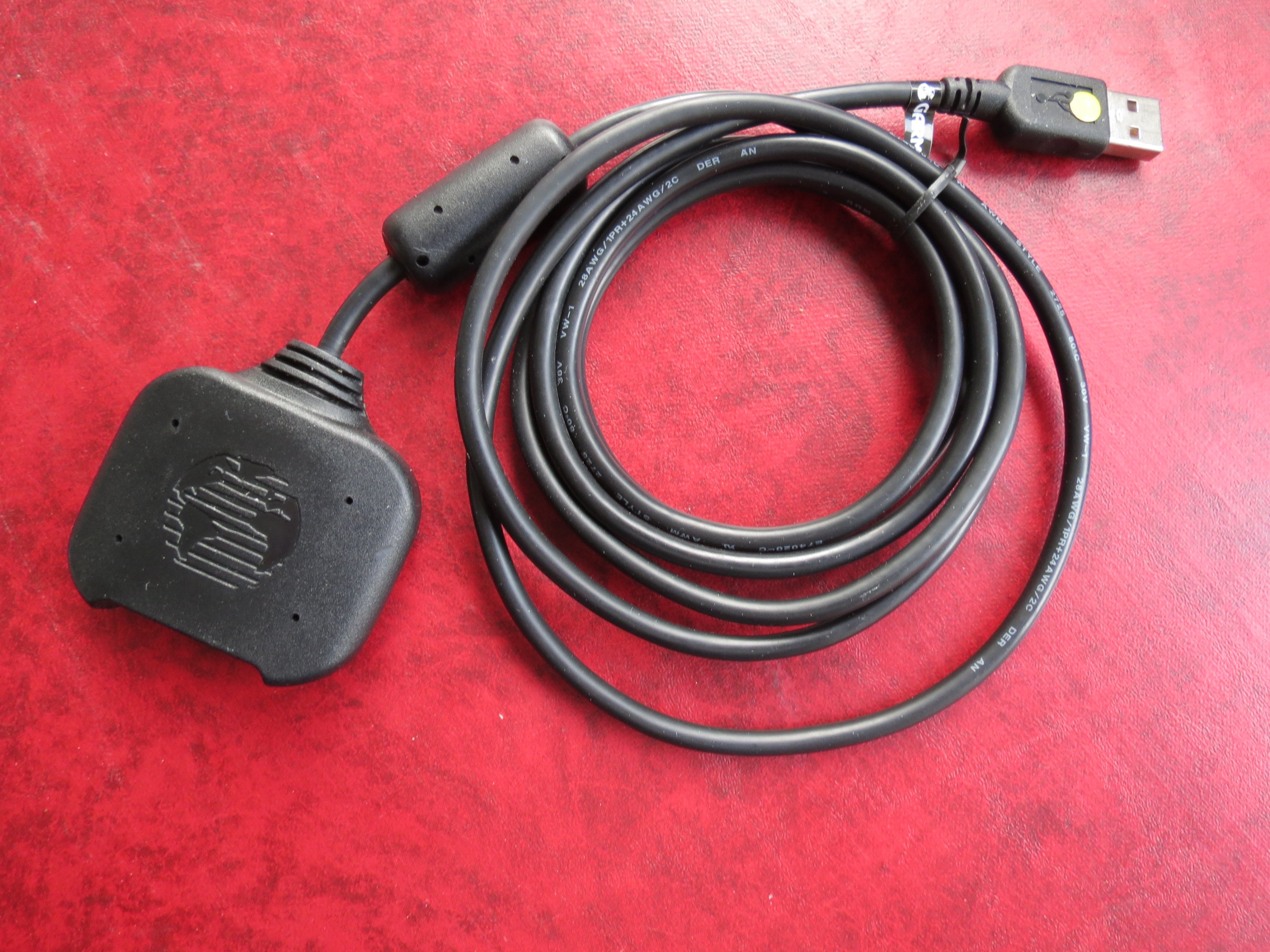

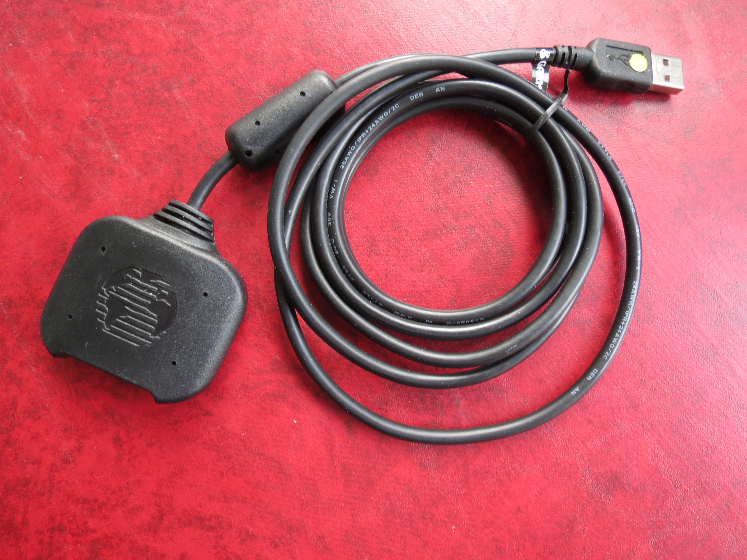

I have both the reader and the version 3.40 upgrade card. All you need is the upgrade card to install the latest firmware. I will be happy to provide. I can send you the upgrade card with your sworn promise to return it, or if you have a card you can send it to me and I will load the update onto it and return it to you.
Advise your wishes.
