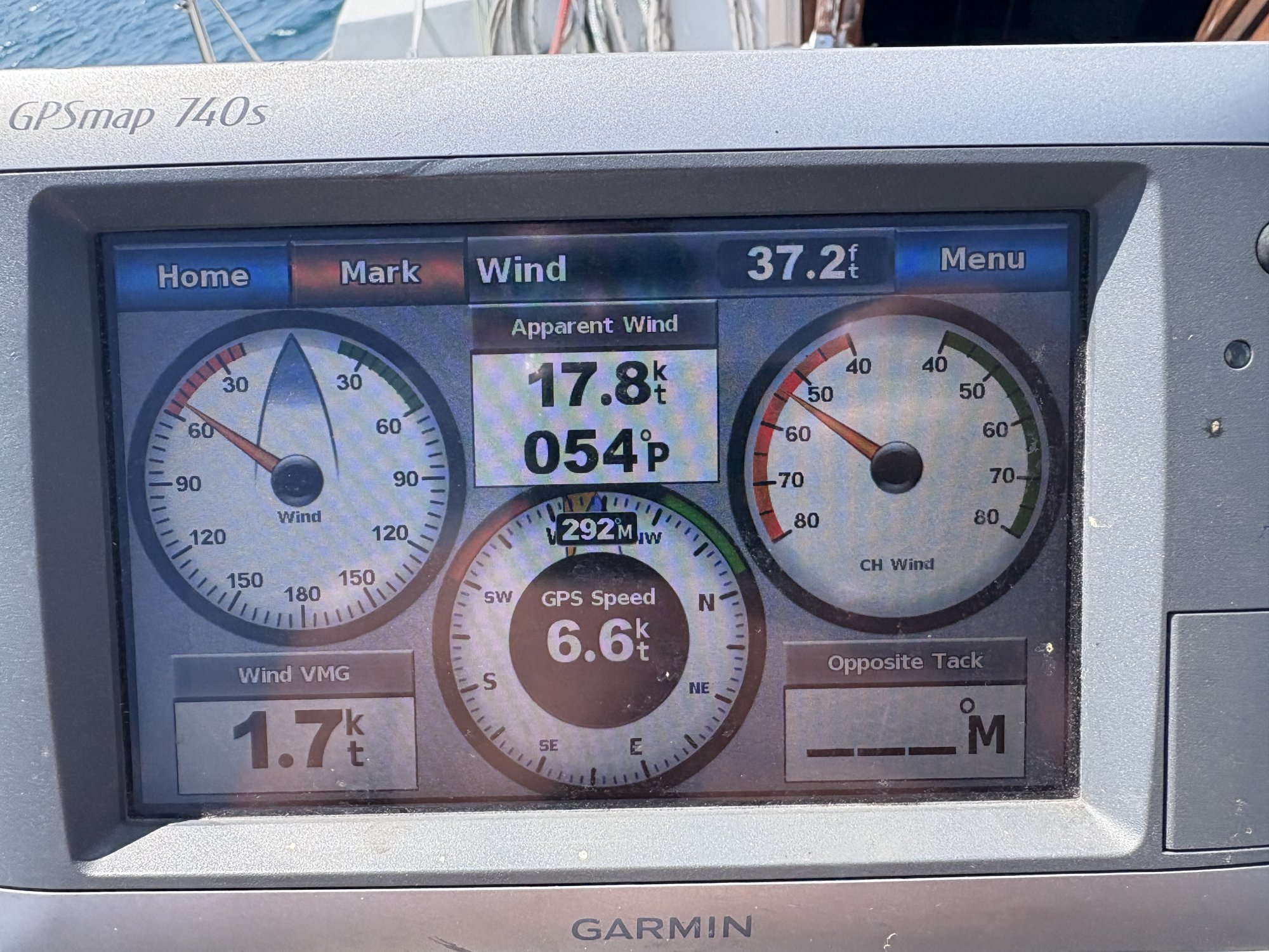

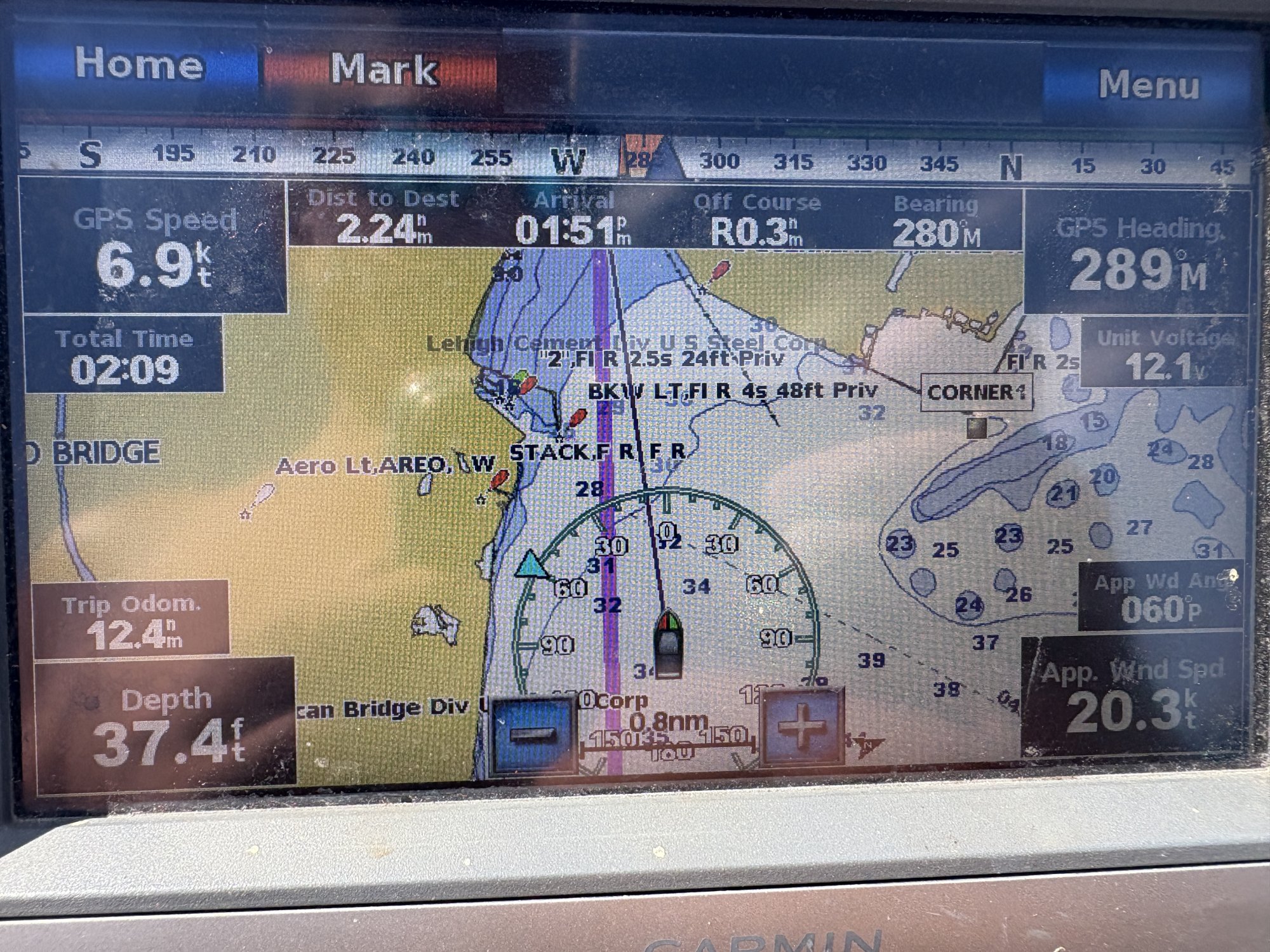

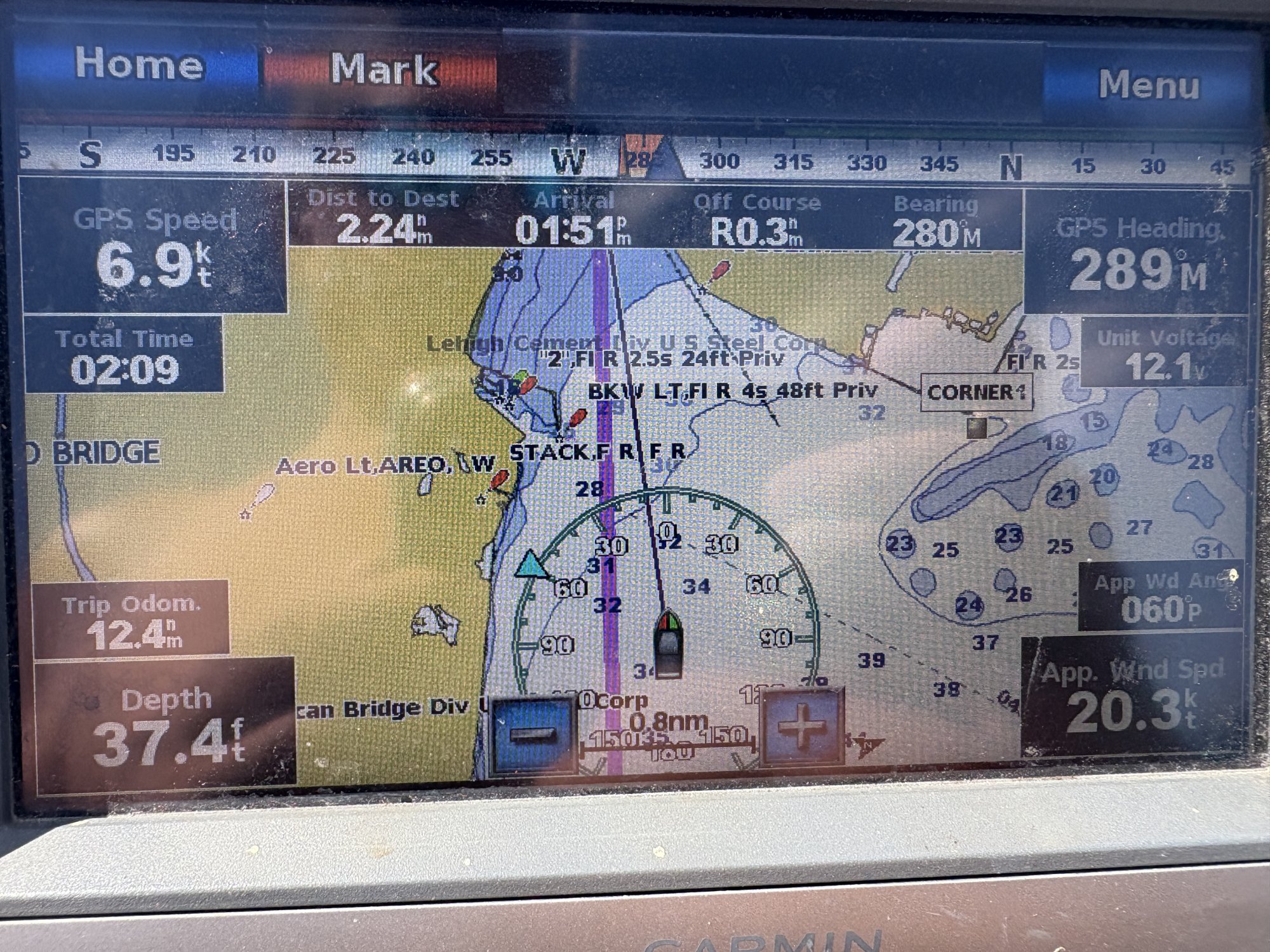

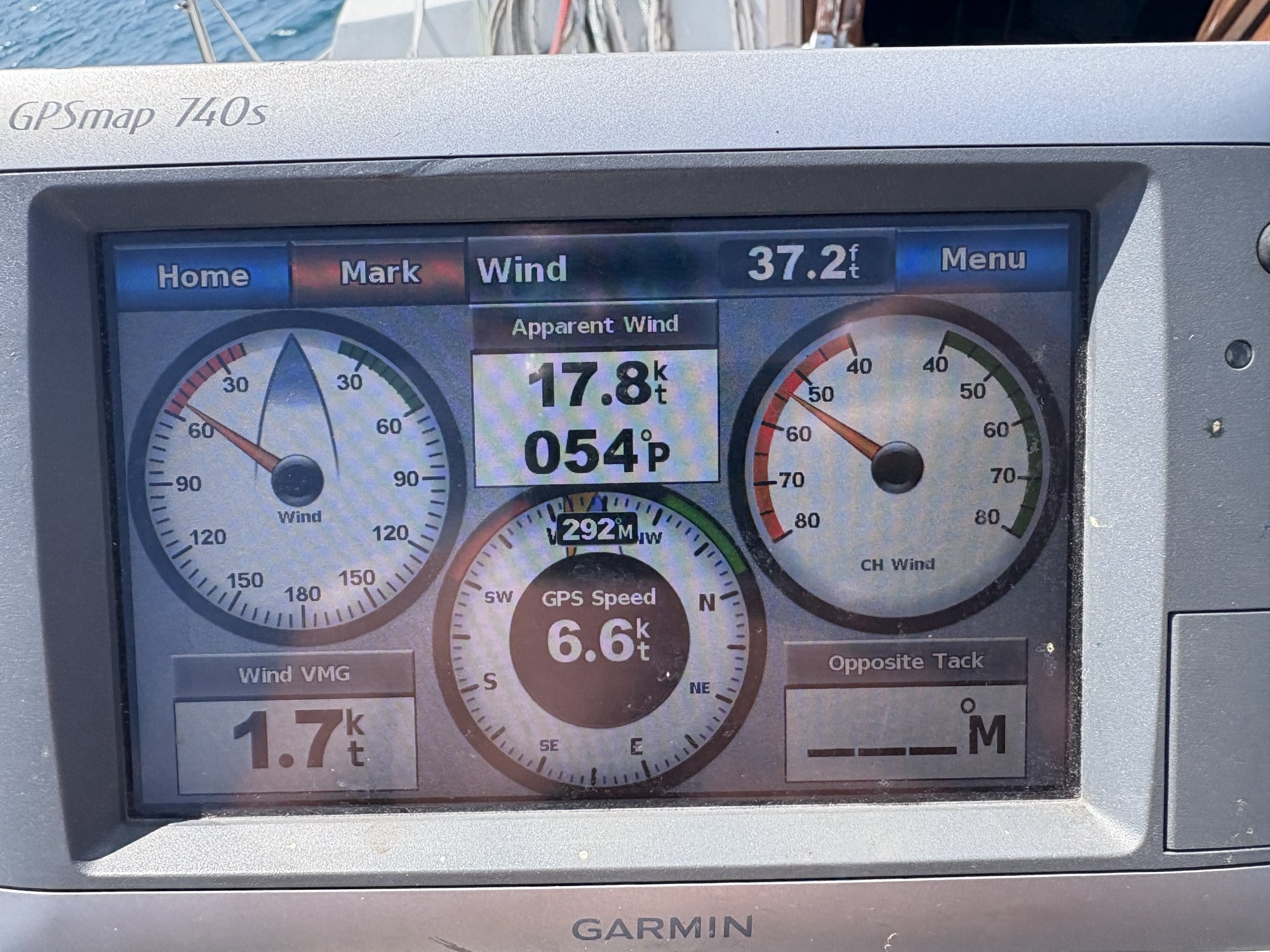

I have a GPSMaps 746 on my boat, and I love having it at the helm. Mine may have more connectivity, and runs off my house bank all the time...no battery pack.
Other folks swear by the use of their phone or tablet running various nav software…
So, maybe try it and see.
