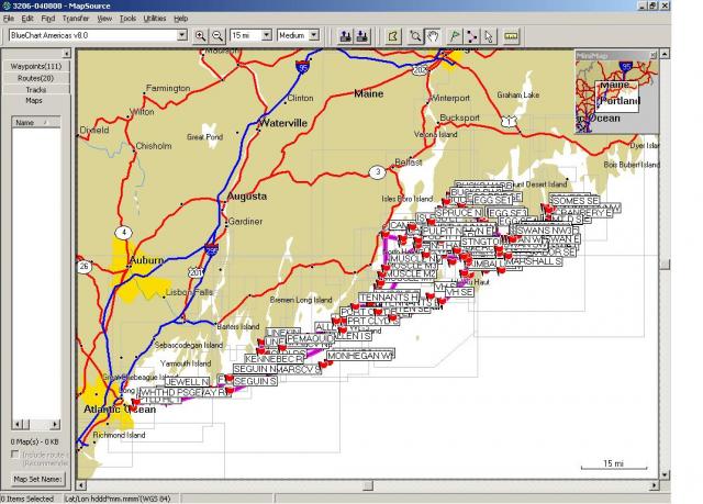

Roger, I have 2 Garmins that I download charts via computer. Etrex Legend and a Quest II. I once had a Garmin 182c(old boat) that I also downloaded charts to. The 3206(present boat), according to Garmin, does not support this function. You must download charts to a chip programmer and insert the chip into the unit. The 3205 is the same GPS but with a slightly smaller screen and keypad. A friend and I share a card reader to update FW on our units. I am still running the original built in charts but plan on buying the Maine chip this year. When you plug in the Maine chip, it overrides all the charts but the unit runs faster(according to MS).
That being said, you can connect your 3205 to a computer via serial port in order to update waypoints and routes. I use this method while cruising as it is much easier to plan on a laptop then the CP. I have wayponts and routes from here all the way to NE harbor and in between. Let me know if you would like a copy of them.

I have my 3206 mounted at the helm and ran the 2 wires needed(18 ga) to a DB9 at the nav station where I can plug in my laptop.
