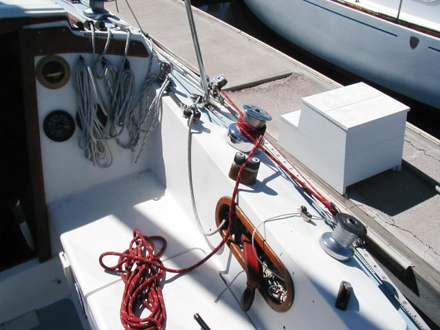

Here's an installation tip:
The car may be difficult to move backwards under load if the sheet angles up sharply to the winch. This was the case in my genoa track installation, so I ran the sheet horizontally from the car back to a turning block, then up to the winch. I used the old car and lead block to re route the sheet so there would be no upward pressure on it. Here's a couple of pics... red line is the sheet. By the way, I remove the control line, bungy and sheets when I leave the boat... helps preserve them and it only takes a few moments to rig it up.
