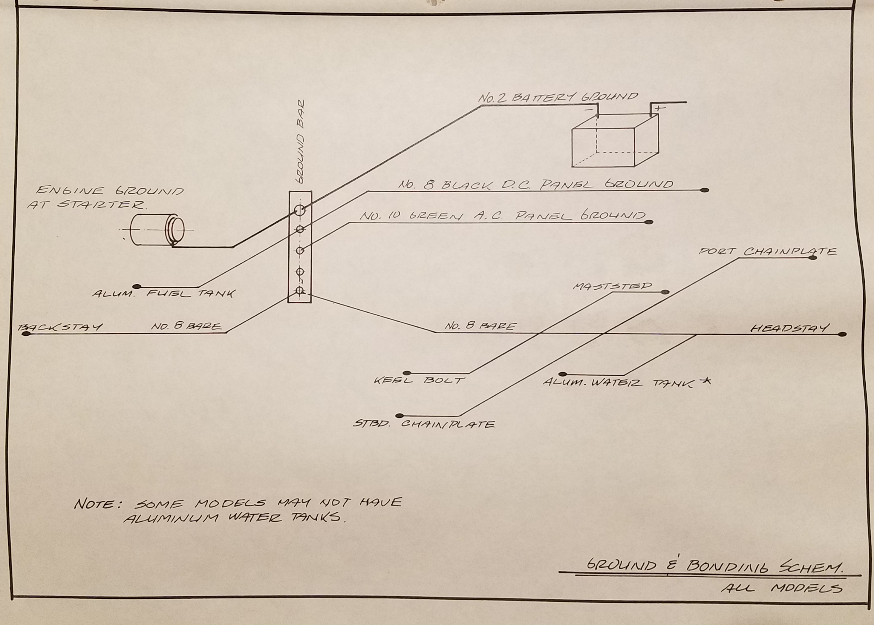

I don't see it in the drawings, however my buddy's 375 first has it ,another friends 331 has it and my 351 has it,so I would go out on a limb and say this is how Beneteau does it, they don't ground the mast. I'm going down tomorrow and I will take a pic.I thought it was a fuse at first and was blown not grounding the mast until I found reference to it on other fourms. The gdt is connected to the keel.
