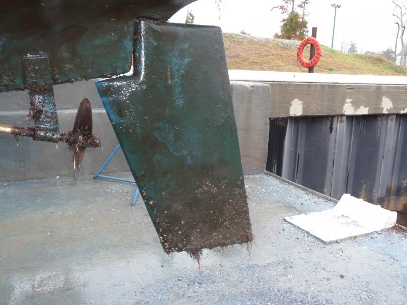

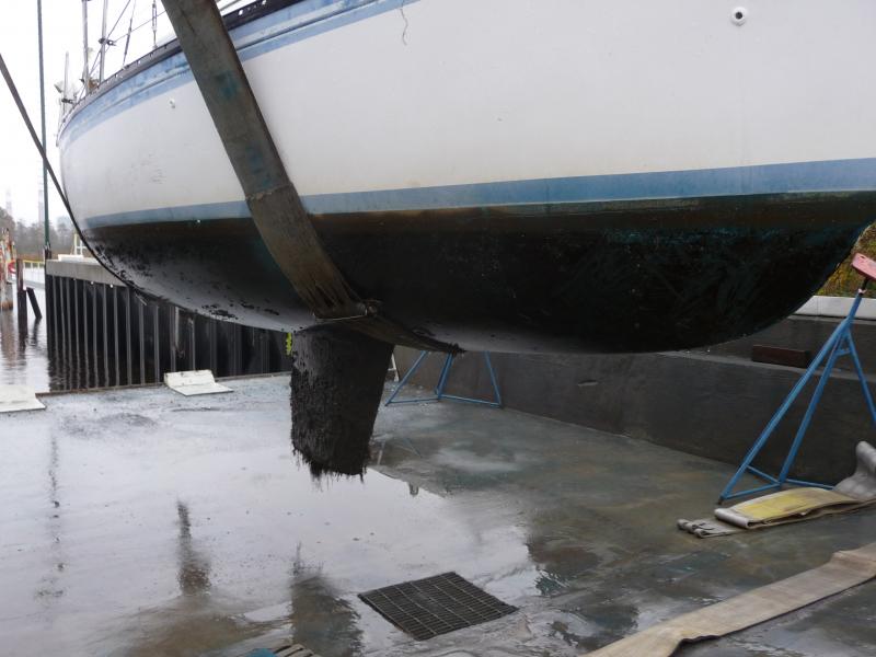

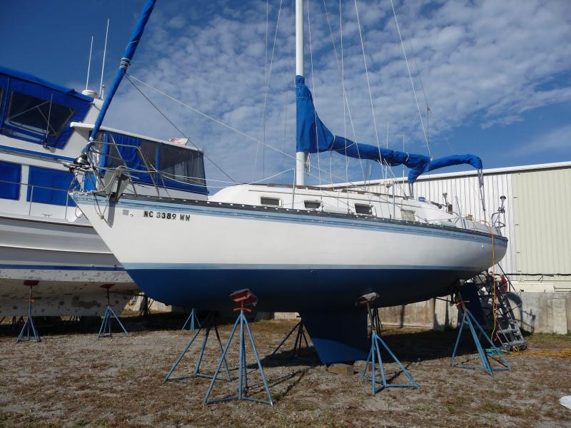

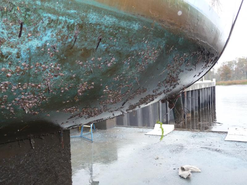

I've used Ultra for 10 years now on '84 h27. On h27, one gallon does one full coat - I put on two coats and it lasts 3 years in dirty, brackish tidal river water. first year, botton remains perfect. By year two, dirt/mud from river starts to build up, so I brush botton 1 or 2x/ yr. Year 3 small areas of critters start to show up, but still good performance. See pic below of last haul after 3 years. Also see After pics. Since I know 3 year schedule, start looking for paint a year ahead - got 2 gals of Ultra Black on Ebay for $79 / gal. !!
