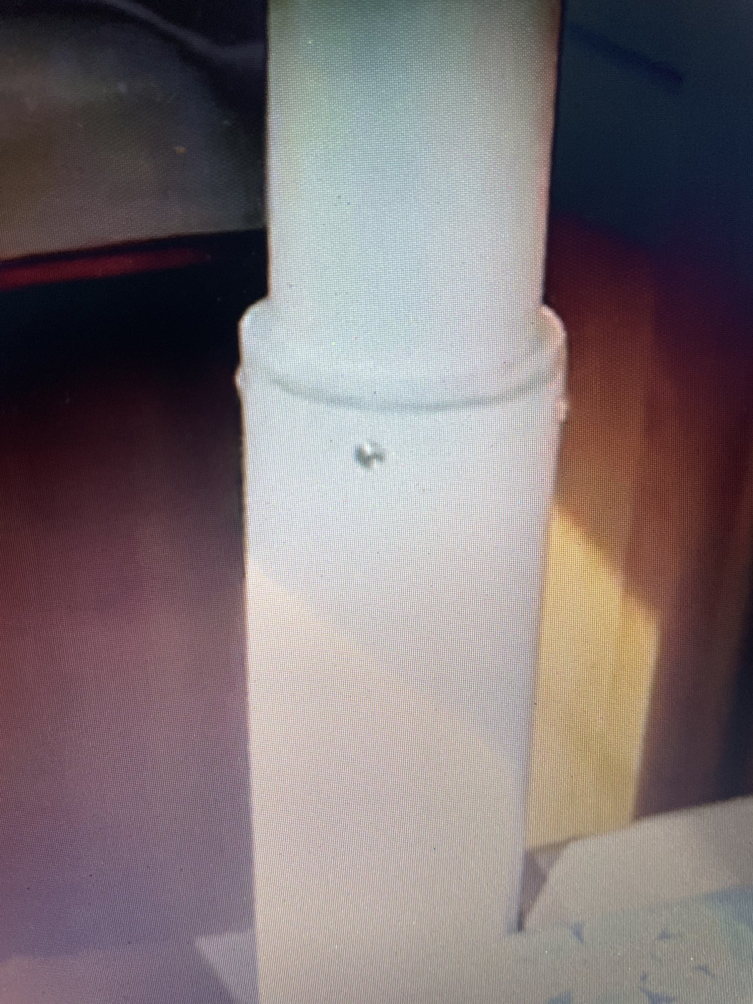

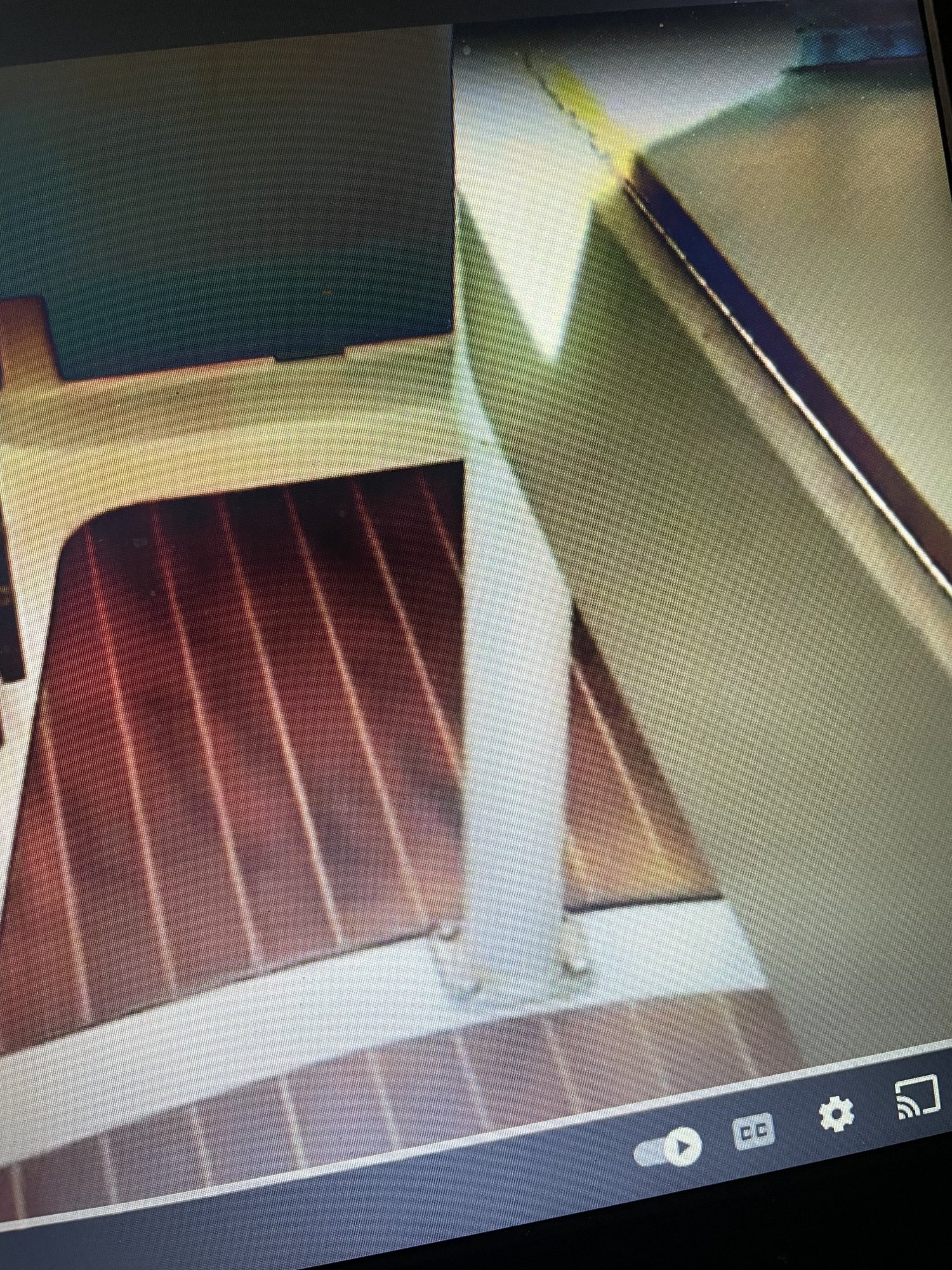

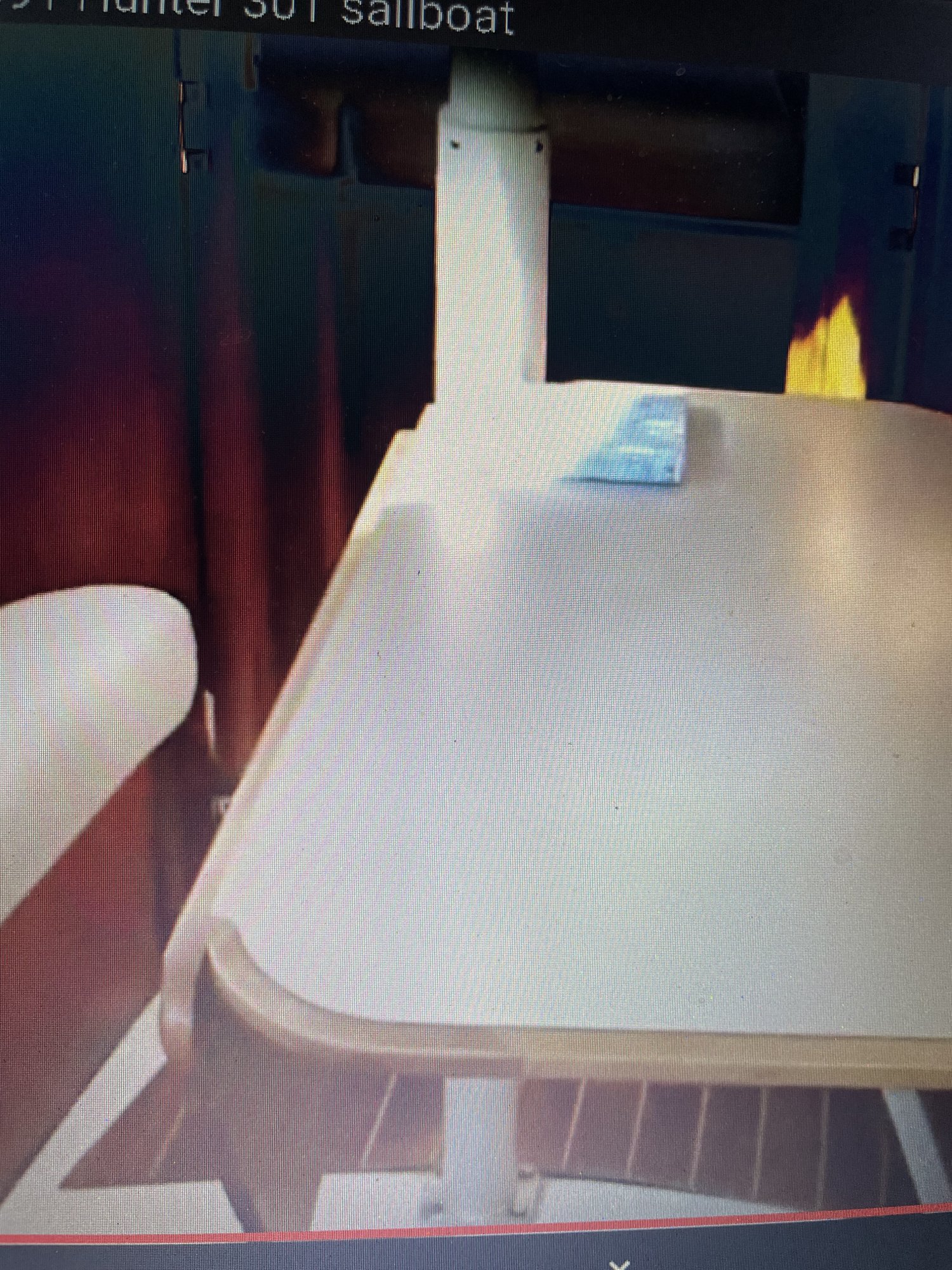

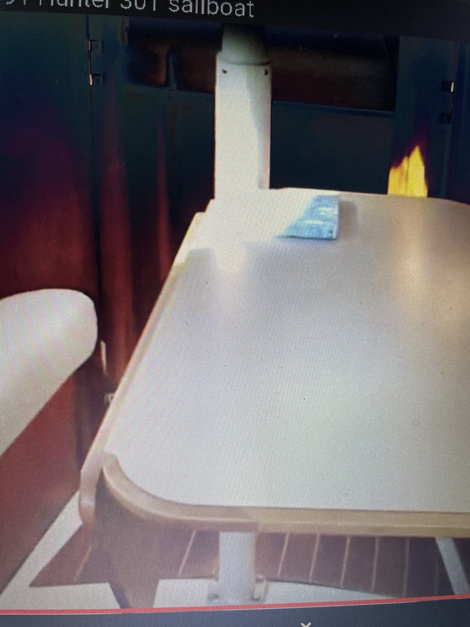

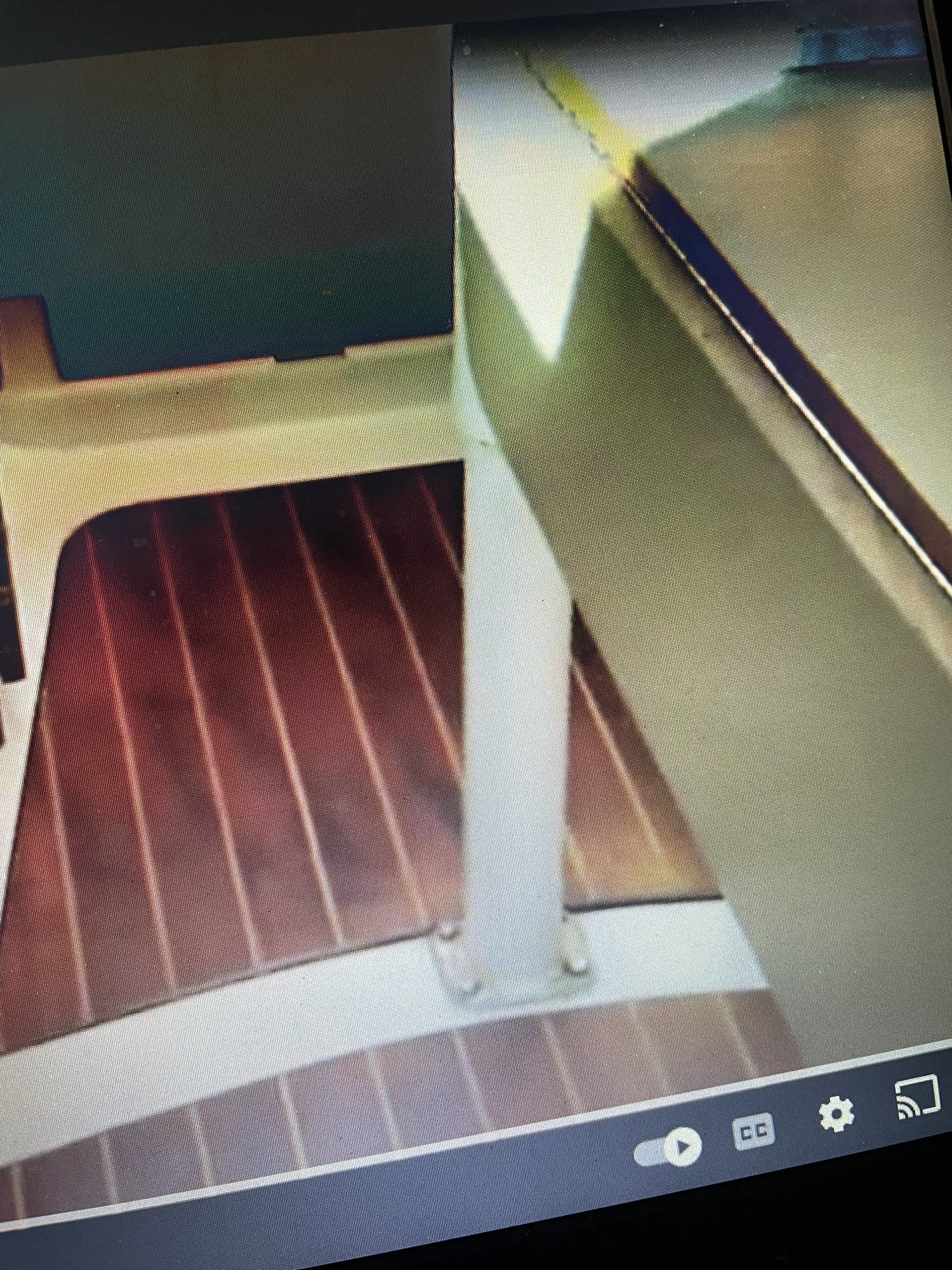

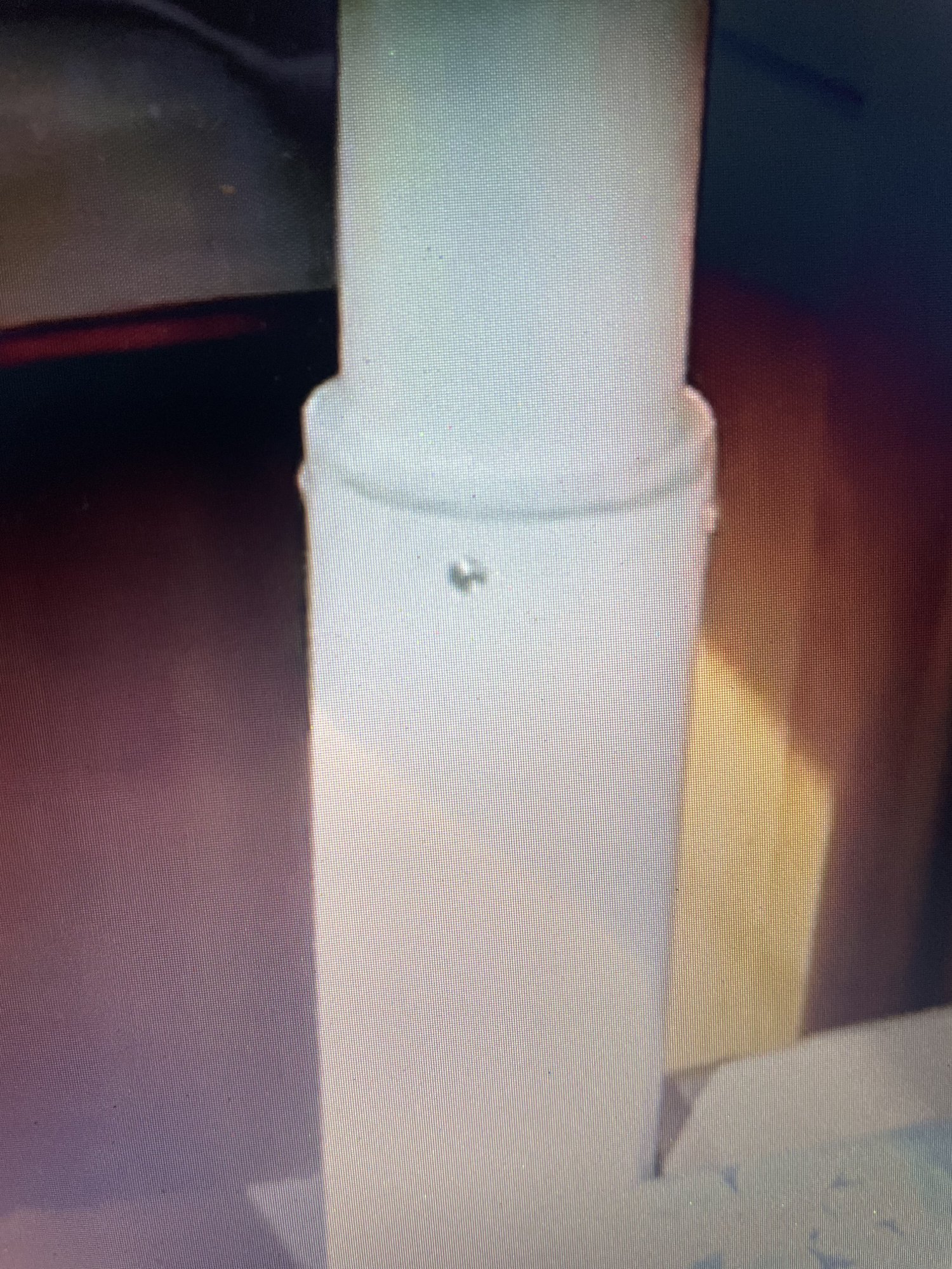

Here is a screenshot of the problem area. The table is mounted to an outer collar that slides up and down on the steel compression post as seen in the pictures. Not sure how the rust even began but if it hasn’t been budged in 20 years… These pics are not from the Hunter I'm looking at. This one obviously functions properly.

Had the same problem on my Hunter 35.5. The rust was on the lower sleeve that travels the post at the lower plastic bushing. No amount of lube helped. Ended up using an angle grinder to cut off the lower end of the sleeve. Then reused the bushing at the new ‘end’ and drilled new set screws into it to hold it in place. in my case the post itself is covered in plastic and it is fine.

Thanks Kellerd! That's the exact way I was going to approach it if I ended up purchasing the boat. My fear was that the rust may well have made its way into the compression post and compromised it also. Maybe that's not the case and my fix will be similar to yours. I am going to go ahead with the survey and proceed from there. Thanks for all the replies!!
