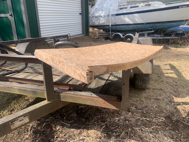

Timm - yeah, it didn't fare too well. Here're the counters I replaced in my galley:

Did you laminate the Formica yourself ? How is the counter top adhered to the cabinet itself ?
By the way .it came out really nice

That particleboard should have never seen a boat. I use to build and install kitchen cabinets, and even in a land-based kitchen, particleboard can swell. I've replaced plenty of countertops with laminate on plywood because of that. OSB is better, but still has swelling issues sometimes. Besides, particleboard is not light.

Sorry, didn't see this before - yes, I glued the formica (contact cement) to exterior grade plywood sealed with epoxy. The counter top is attached to the sides of the cabinet using cleats made from a short section of 1 x 1 teak. - in fact the whole cabinet is new and assembled with cleats which allows it to be easily taken apart. Here's a simple diagram - screws are driven where the arrows are pointing:

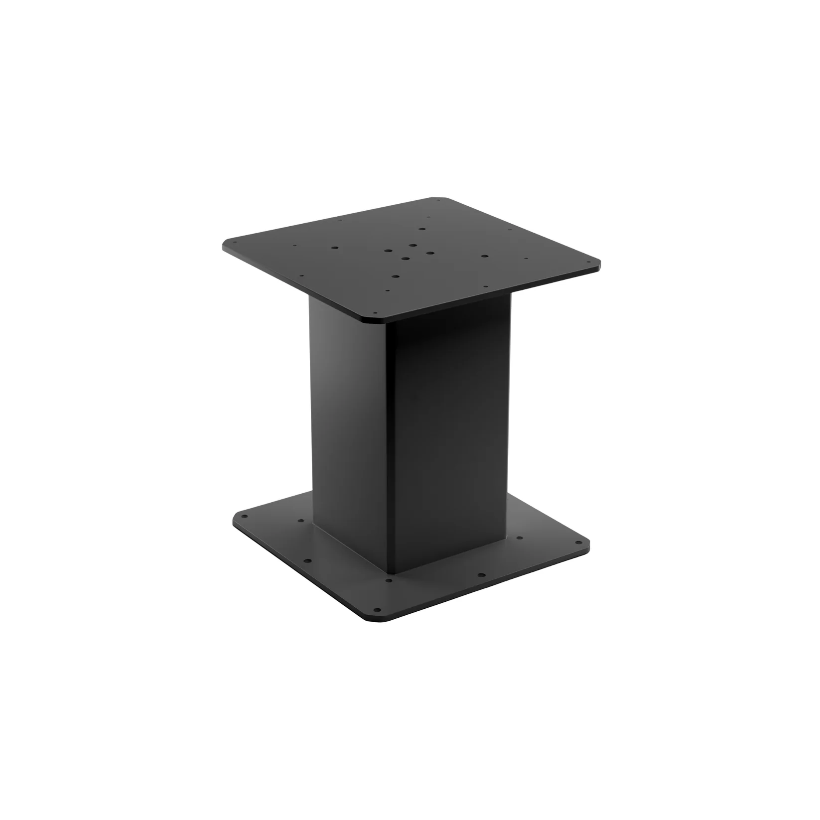

I looked for a pedestal for my table. It is a lamented piece of plywood. 3/4 thick. It functions as the base of the double bed in the cabin.
Because I have a fuel tank beneath the cabin deck, I needed a pedestal that collapsed within itself. The extended height required is at least 28" from the deck and 14" when set for the bed. I found this LG-11 Modular Lifting Columns with Remote Control from a Canadian company.
