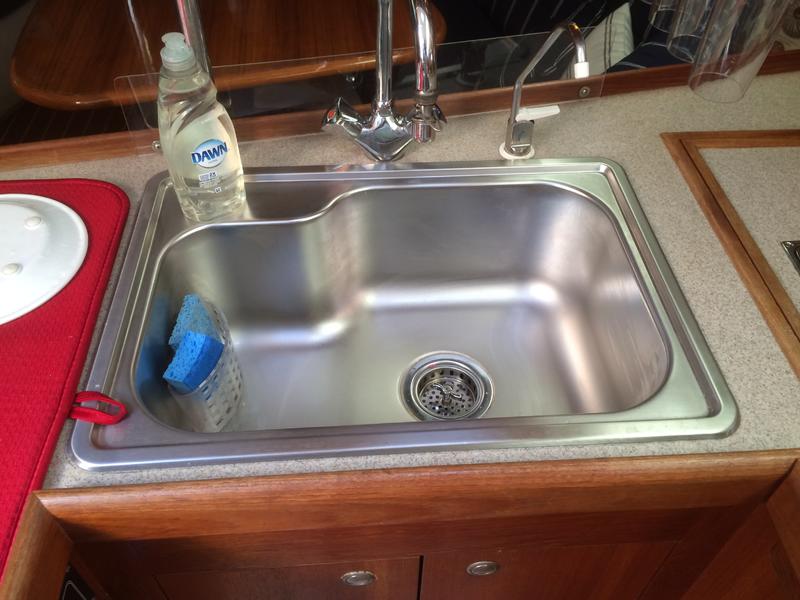

The old double sink bowls in our 376 were too small so I replaced the double galley sink with a single SS sink. It took a lot of searching but I found one through Homeclick. The sink wasn't an exact drop in but I was able to cut the counter top with a sabre saw. Lot's of measuring and positioning. [FONT=&quot]Just be very careful in checking the dimensions of the template vs. the actual sink.[/FONT] [FONT=&quot]Homeclick product: "Whitehaus WHND1913 Noah's 22-1/2" Single Bowl Drop-in Sink in Brushed Stainless Steel". Homeclick was great to work with. [/FONT] [FONT=&quot][/FONT] [FONT=&quot]

The old double sink bowls in our 376 were too small so I replaced the double galley sink with a single SS sink. It took a lot of searching but I found one through Homeclick. The sink wasn't an exact drop in but I was able to cut the counter top with a sabre saw. Lot's of measuring and positioning. [FONT=&quot]Just be very careful in checking the dimensions of the template vs. the actual sink.[/FONT] [FONT=&quot]Homeclick product: "Whitehaus WHND1913 Noah's 22-1/2" Single Bowl Drop-in Sink in Brushed Stainless Steel". [/FONT]
