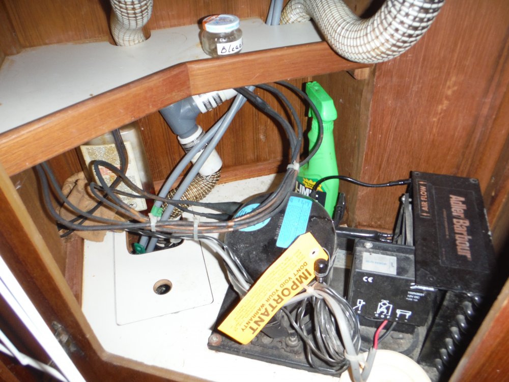

I am pretty sure this is 1-1/2.. boat is in MX, does anyone know the size? See pic. It must be the 1-1/2" "shieldvac" listed in the manual. Just wanted to be sure before I spend the $$. I want to replace it. It is the sink drain and think it is getting brittle. Not good below the waterline....

I'm not so sure it is 1 1/2. I know Rich Stidger (40.5) recently changed his out. You might want to send him a private message. Also, the guys here at the site store likely also know. Good luck!
