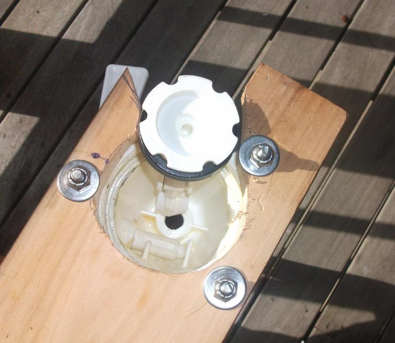

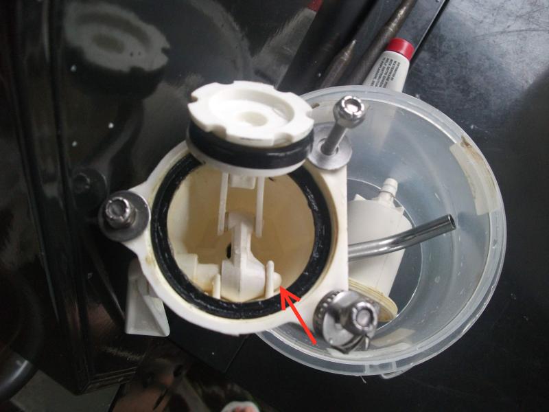

I overhauled mine about 2 1/2 years ago. To quote my notes:
"Replaced O-ring on handle shaft - old O-ring was 9.5mm ID x 13mm OD and I replaced it with 8.0mm ID x 12mm OD (from one-way valve in female garden-hose end). In other words the replacement O-ring was 2mm thick v's old O-ring at 1.75mm thick."
When you open the body you can see the handle end as in the first photo below.
I cut out a hole in a timber plank (see second photo) to bolt the body onto and held that plank in a vice. I then just used a screwdriver to help push the handle end (arrowed in first photo) through the plastic holder whilst easing the spindle out with the handle ie. pushed on the screwdriver gently whilst wiggling the handle to ease the shaft out. In this second photo you can see the handle spindle end has just been gently pushed through its support bracket but is still sitting inside the tap body before the spindle is totally extracted.
Having the tap body held in that frame made the job very easy and it only took a couple of minutes to cut the hole out and bolt the tap onto it.
I just used tap o-ring grease from the plumming shop to recoat the o-rings before re-assembling.
My tap had the following markings:
"Free-Flow Products" RV&Z240.3.2 (on handle)
T-1353 18-860 (on tap base)

Oct 21, 2010
350
Macgregor 26S, "Myuna" Brisbane, Australia
That's my model. Did you do anything to the rubber 'seal' on the plunger?
No Justin, I just lubricated the plunger o-ring with tap grease. Not sure which brand, but either:
Hydroseal Tap Lubricant http://www.relianceworldwide.com.au/about.html or
Vinoleo WT90 http://www.macdermid-eu.net/jointingcompounds.htm
I am sure any tap grease from a plumbing supply place would do the trick.
As I said I replaced the O-rings on the handle spindle with ones as close as I could find and everything works fine now - it was previously leaking a bit around the handle. They are not a very high volume pump but we seem to get by with it.
Sometimes they need a bit of priming by having the water source above the level of the tap, but once they get going they are fine. I think you would only have to prime it if it had not been used for a long time. I work from 3 x 10l plastic jerry cans under the front bunk and when I change the suction pipe over I just make sure I don't loose too much water from the line.
