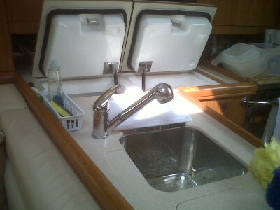

Galley faucet...
Bob:
Here is a pic of one we installed a little over a year ago. The single handle design is much more convenient. We found it online for $15.
Doug.

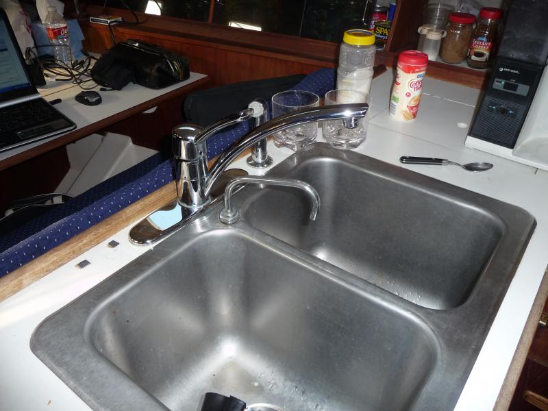

Mar 3, 2012
856
Hunter 34 Punta Gorda
We purchased a Glacier Bay with TOP MOUNT Installation. This Top Mount made it extremely easy to install.

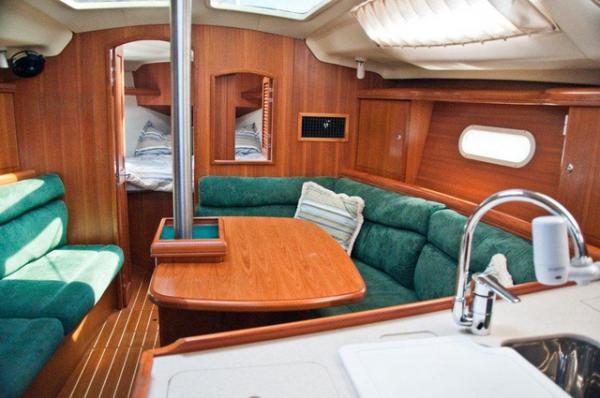

Apr 8, 2010
2,091
Try Scandvik
Good quality chroming is important in a marine instalation. Best to avoid the cheapie hardware store stuff.
When our originally '88 Grohe galley pull-out faucet finally started looking rough, and considering the abuse the prior owner had done to the hose, we went with a Scandvik unit.
Not cheap, but it works beautifully, and will probably be the last one we buy for the galley.
