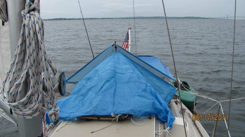

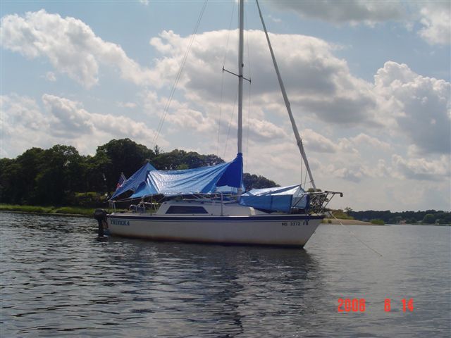

No, I didn't waterproof it. It was primarily used to shade the cabin while the boat was at the dock. It did work out nice for our 3 days in Echo Bay at Sucia as pictured above though.
Part of the reason I only got 2 seasons is that it tore on a seam when I was taking it down while it was wet. I think by then the fibers had been weakened by the sun/rain; it got pretty heavy when it was wet too. One nice thing is that it was thin enough to filter the light and also "breathe". Not sure sunbrella would do that. OTOH, sunbrella wouldn't have to be replaced as often.
The next one I make may have a couple or 3 tent poles to give it more of an arched shape and help keep it out of your hair at the edges. If I can get the Admiral on board (she got a new serger for xmas) I might even design it so there's a tab in the middle that I can connect the main halyard to. That would let me raise it up so it wouldn't actually rest on the main sail cover.

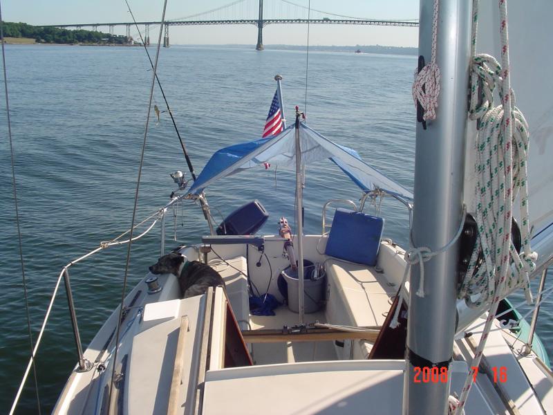

I've been using polytarps on my boat for years and they work out pretty good for sun and rain protection but they can be noisy on a windy day. I've been thinking of making a tarp out of Silnylon just to try out. It's a light weight material that would take up less room and it's probably quieter on a windy day. Here's some links on different materials and waterproofing techniques used:
