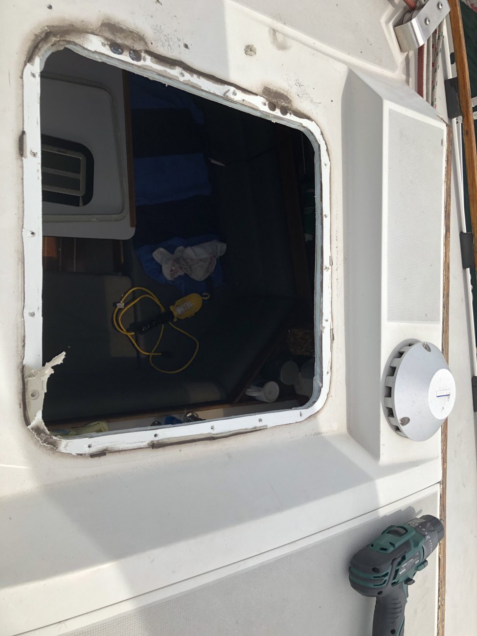

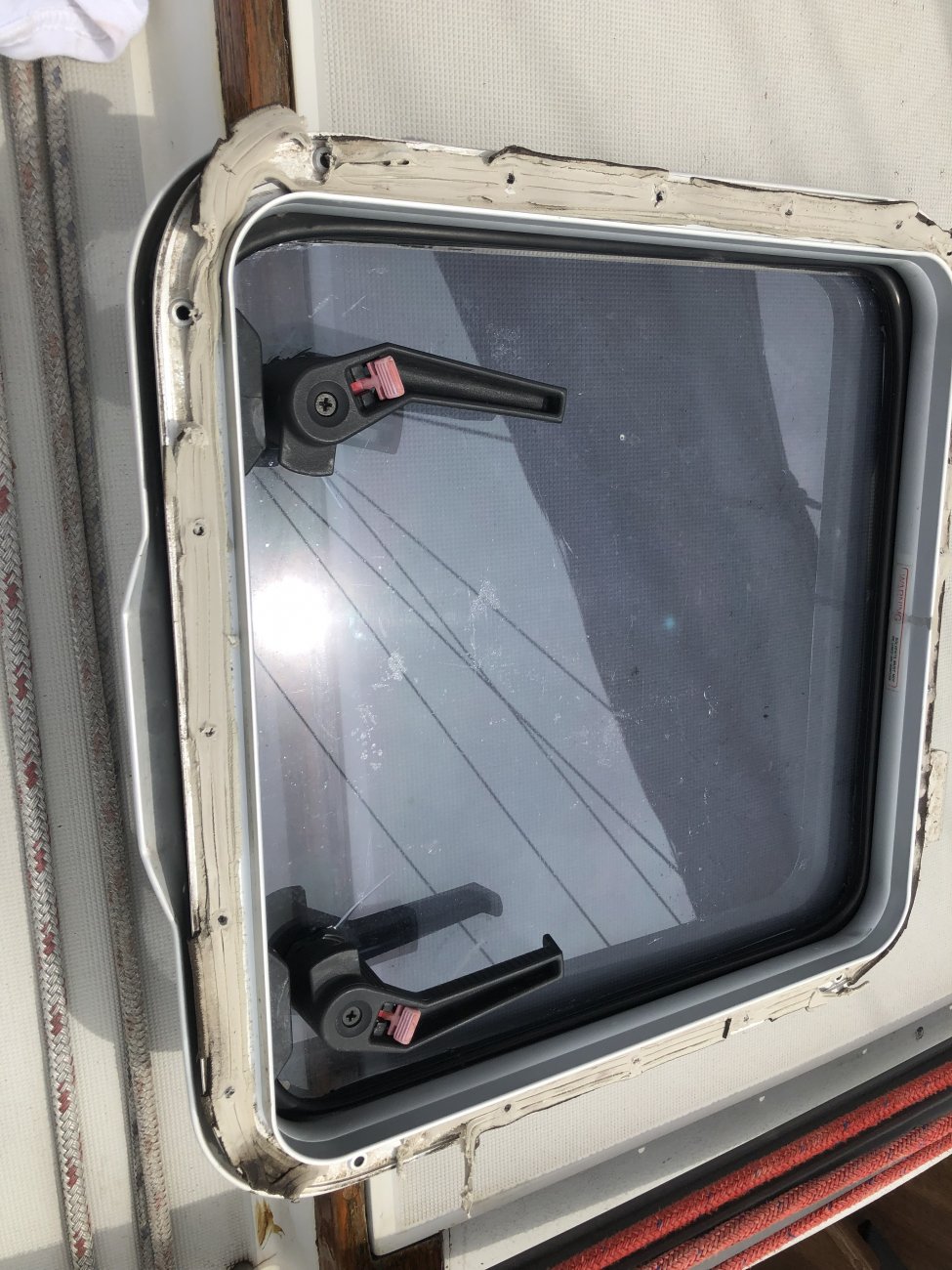

I pulled my salon hatch a few weeks ago for the same reason...
C4BBCC67-D2D6-43A2-971E-8C785449DB41.jpeg 005EB916-FFF9-4022-A275-63464D670FE4.jpeg
You can see dark areas around the hatch and the deck...the old butyl was shot and water was leaking in there.
Rebed with some butyl tape and seems to be ok now.
