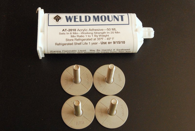

The piece of starboard was mounted to the hull using Weld-Mount studs..
