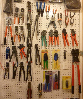

And if you are really keen on tools I'll bet you've already tossed out that mechanical wire stripper in favor of the hot wire insulation removal method, but then maybe not.
More often than not those old mechanical cutters will cut or weaken conductor strands as you struggle to pull the insulation from the bare conductor.

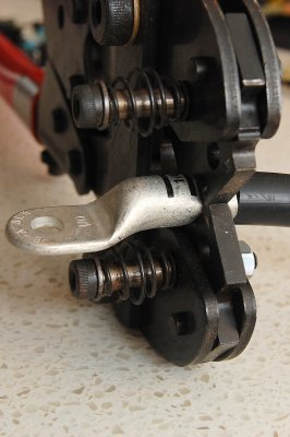

talking about. I do want to emphasize that stranded wire has to be used
because it can stand the flexing (soldering turns stranded wire into solid
wire by the way). And when crimping the connectors please don't use as $2
crimper, go and buy a really good one (and also use only the best marine
grade connectors). I am always amazed how folks will pay thousands of
dollars for a boat then try to do the repairs and upgrade on the cheap.
