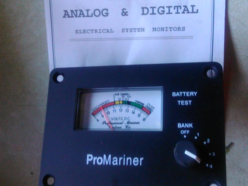

A new-in-box vintage ProMariner analog battery monitor recently came into my possession. Photo attached.
All it really does is show the voltage for each of up to four batteries on the meter as the selector switch is rotated. Just a crude measurement of battery state at best. :Liar: Nonetheless I want to install it on my plastic classic boat.
I will be "monitoring" three 12V batteries.
Question: Do I need to install <1amp fuses for each of the three wires that will lead into the monitor?
Two of the +12V wires will only be about one foot in length between my 1/2/Both switch and where the monitor will be mounted. The third wire will be about eight feet in length from the emergency reserve battery which is normally isolated from the 12V system by it's own dedicated high-amp switch.
Considering that the ProMariner monitor will draw only milli-amps, voltage drop over wire distance shouldn't be much of an issue. So I am thinking only say 18-22 gauge wire will be sufficient. The single negative wire with thick insulation can be robust in comparison - say 14-16 gauge. Other than right behind the battery monitor, each positive wire will be well separated from any negative contact possibility.
The instruction sheet that came with the monitor doesn't indicate installation of any fuses at all.
