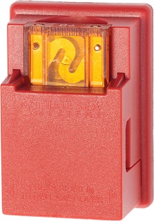

I have a Blue Sea 5006 fuse holder like this one with a 50A fuse
For a 10A fuse I'd probably just go with an inline blade fuse holder. Don't use the cheap tube fuse holders, they don't last. If the solar controller is close enough to the battery (or +ve terminal block) then you could just crimp the proper size ring terminals onto the fuse holder pigtails and hook it up. If the pigtails aren't long enough then you will need to crimp on a longer wire. All fairly simple to do for this size wire and getting a good crimper is a very good investment.
