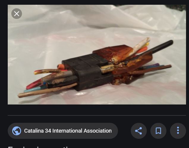

It's been a while but I believe the engine panel power wire is on the starter solenoid. There may be a fuse behind the engine panel. Also important - there are two "gummy" plugs in the panel circuit. One behind the panel and one in the engine compartment. These are subject to corrosion that leads to poor connections creating heat and melting the plugs. There is more info on the Catalina group and Catalina 30 owner webpages.

While you have the panel out, look for the "gummy plugs" and plan to replace if not previously done.
